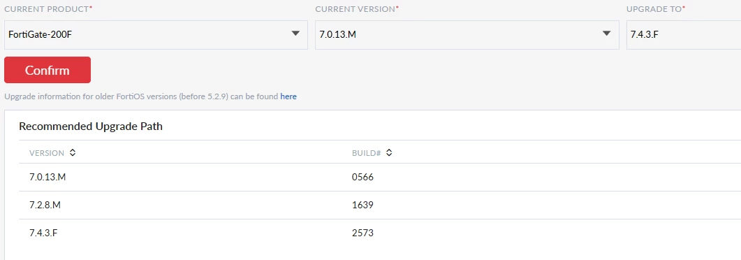

However, I generally don't trust upgrading FGT through those earlier versions, like 7.2.2F, 7.2.3F... those might have potential problems. I wouldn't target like 7.4.3F either while the latest 7.4.8M is available. I would recommend upgrading the cluster to like 7.0.13M first, so that the big jumps 7.0.x->7.2.x and 7.2.x->7.4.x wouldn't have to go through those lower F(feature release) versions.

Based on your guidance, I would like to first change the milestone for the firmware upgrade.
While I strongly prefer to set it to 7.4.8M as you suggested, unfortunately, due to instructions from another organization, we have to use 7.4.3F.
Additionally, according to your advice, it would be better to perform "diagnose debug config-error-log read" before and after each firmware upgrade to verify that there are no issues, and to make minor adjustments if problems are found. Is my understanding correct?
