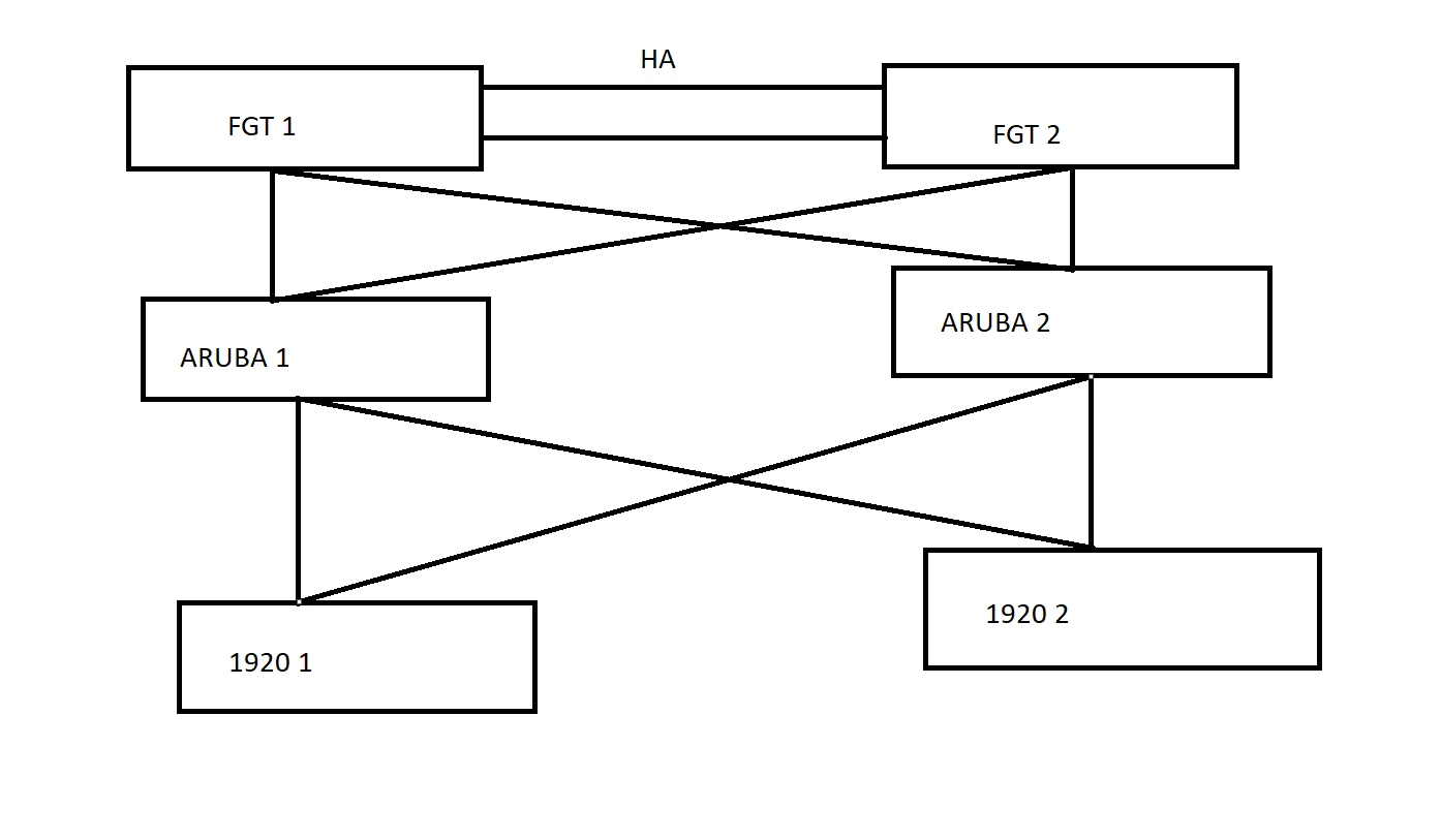

      I think that your scenario is acceptable, but in my opinion i think that this is not the best practice as you don't have ha at the Aruba switches. For example, if Aruba Switch 1 fails, then everything fails. I would suggest a configuration like the screenshot below.
      In my scenario, if a FGT fails, everything continue to work fine. If an Aruba fails, you lose only the connected servers and machines at that switch. Same for 1920's.

      would you have any idea how HA can be setup on the Aruba switches? I'm asuming this isn't just a matter of cross connecting the switches as this would be a loopback.
      orani
      July 23, 2019
      You have to enable the spanning tree feature at your aruba and 1920's. You can find it under "Traffic" tab at your web gui.
