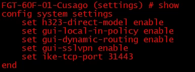

this is the output of diag sys tctpsock | grep 11443
ike-TCP-port:
config system settings
set h323-direct-model enable
set gui-local-in-policy enable
set gui-dynamic-routing enable
set gui-sslvpn enable
set ike-tcp-port 31443
Translate

Hi,
Could you please confirm from which previous firmware version you upgraded to 7.4.9? Please verify if port conflict between TCP 443 and the IKE TCP port. Starting from FortiOS version 7.4.2, a proprietary solution was introduced to enable the encapsulation of Encapsulating Security Payload (ESP) packets within TCP headers, and this allows ESP packets to use a specific TCP port.

Hi
upgrade from 7.4.8 to 7.4.9 and ike tcp port doesn't in conflict with gui https port.
