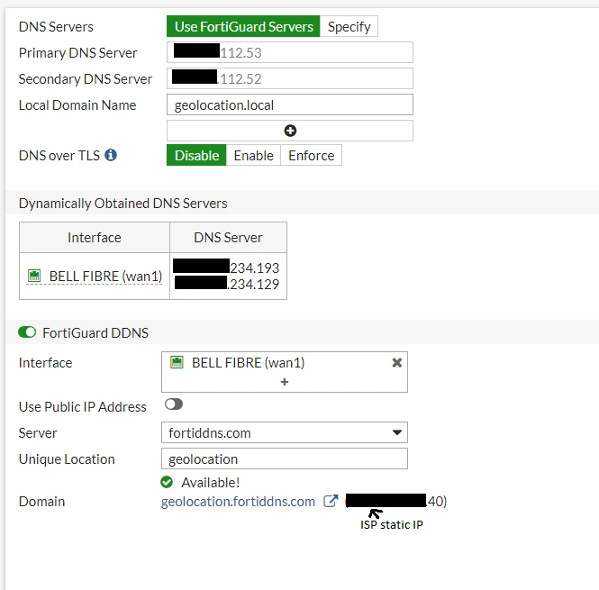

Hi everyone, thank you for taking some of your time to read this.
We switched ISP a couple months ago for a Bell Gigabit Fibe Ethernet. They gave us a HomeHub 2000 that I had to put in bridge mode to stop it from acting as NAT router (first problem).
I then setup the WAN1 connection using the Bell credentials in PPOE and I could not get any signal.
I called Fortigate support and we setup a DNS using fortiguard effectively creating a domain name linked to our static IP.
 Is this correct ?
 I found two similar threads but neither mention if they have static IP. Ultimately I would like to remove the fortiguard DNS server causing latency.

There is no need to configure fortigaurd DDNS if you have static IP.

Thank you for your input @rosatechnocrat, I did some digging up and found that Bell fibre uses VLAN 35. I will try to remove the DNS server and redo the WAN interface.
Actually, I might open a ticket with the support team.

Toshi_Esumi
May 3, 2023
By the way you can even eliminate the Bell HomeHub 2000 like below if you're not using any features on it. It's just a router.
https://forums.redflagdeals.com/bypass-eliminating-home-hub-2000-bell-small-business-account-2405876/
My Lumen Fiber has very similar setup with PPPoE on a VLAN. I eliminated their Technicolor router and terminating the ethernet cable coming from the ONT device at FG40F.
Toshi

@Toshi_Esumi , thank you for sharing your setup. Fortunately, the ONT is in the same room right beside the Fortigate. Did you have to tag your packets ?
Toshi_Esumi
May 3, 2023
Yes. Lumen(formerly CenturyLink) uses VLAN 201. So I've set the valn subinterface with vlanid 201 on wan interface of my 40F.
<edit>Make sure you change the default "DHCP" setting on your wan1 interface to like "static" to avoid accidents or for security.</edit>
