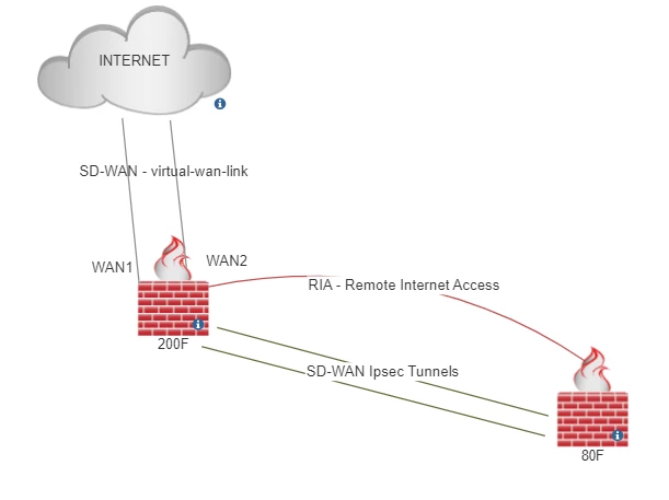

Hello,
how should I configure ftm push feature for branch office with RIA - remote internet access through main office fortigate, the diagram is as below:
FGT-branch # config sys ftm-push  FGT-branch (ftm-push) # get server-port : 4433 server-cert : Fortinet_Factory server-ip : 0.0.0.0 server : status : disable  FGT-branch (ftm-push) # set status enable  FGT-branch (ftm-push) # end Missing server address. object check operator error, -56, discard the setting Command fail. Return code -56
As I understand I need to configure on branch main office's WAN IP in the ftm-push settings, because ftp-push call will arrive at the main office WAN then should be route back to 80F - right?

If all traffic coming from the internet destined to the branch office FGT must come through the main office, then you are right - the server name (FQDN or IP) should be an IP on the main office FortiGate. The main office should then have a VIP + a firewall policy configured to DNAT the traffic and send it to the branch office FortiGate.
