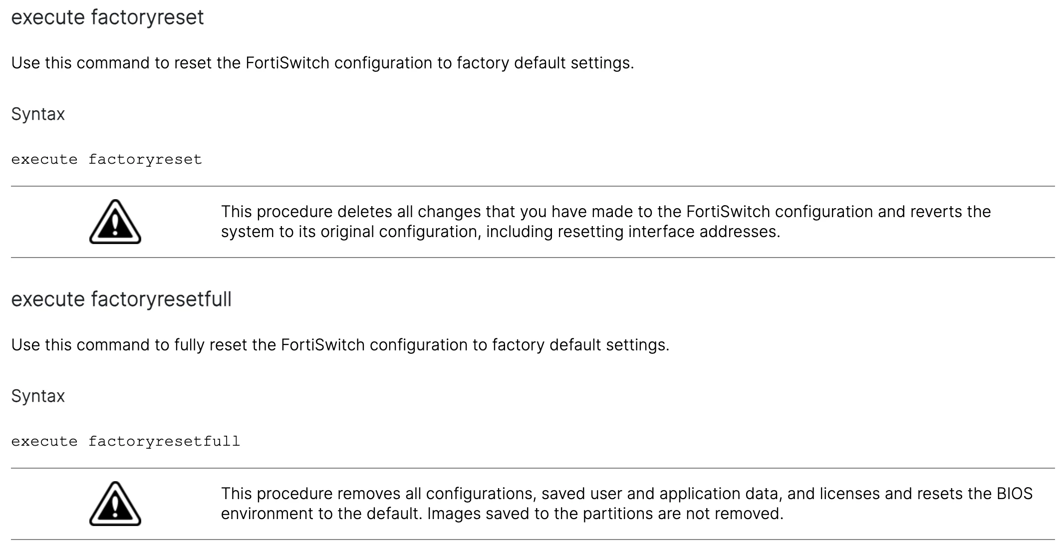

Hi FortiSwitch admins
What is the difference between these two?
factoryreset       Reset to factory default now.
factoryresetfull Fully reset to factory default now.

Hello @AEK ,
I think these warnings explain the difference.

Thanks @ozkanaltas
So the first is about configuration only. I wonder if the second one resets the firmware version as well?

Hello @AEK ,
I think all firmware versions are saved. But just the bios resets to factory defaults.
