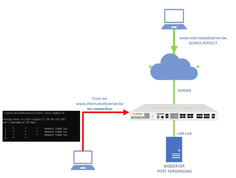

When I try to connect from behind my firewall (lan) through the url (www.internalwebserver.be) to my internal webserver (with portforwarding) I get a timeout on this connection. When i use the webserver lan IP (ex https://192.168.1.20:1234) there is no problem. (just annoying for the users ;-))
When I connect from a remote location everything works perfectly.
Seems to be a DNS problem but I can't figure it out...
Does anyone have advice or tips where to look in the fortigate configuration?

Thanks for your welcome and your fast reply.
I have checked my VIP and associated policies. The problem is not gone yet but it has something to do with it (since I can suddenly ping). NAT was enabled on the WAN to DMZ rule so i changed that. I keep searching en testing, thanks for the very useful insight!
