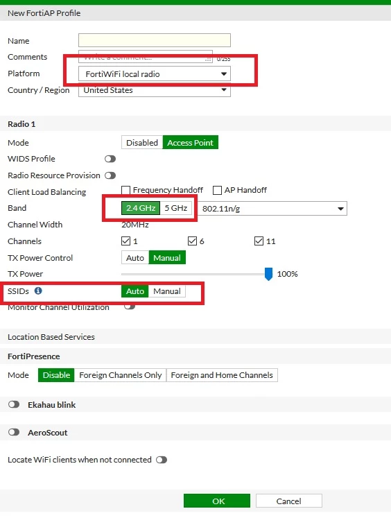

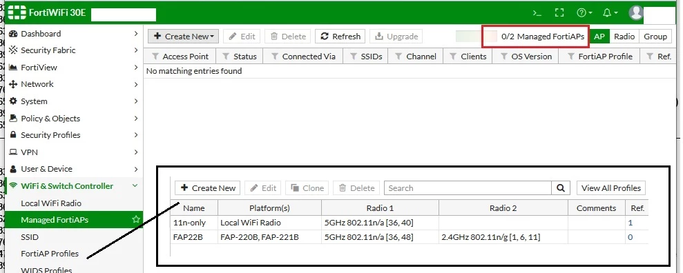

    If you asking if a FortiWiFi model can act as a wiireless controller for FortiAP models then yes, but it depends on the model and firmware compatibility between the two.
    Here is my 30E, which is running on 6.0.x firmware, it can manage 2 FortiAP devices.  I still have to setup the wifi/SSID options via FortiAP Profiles.
