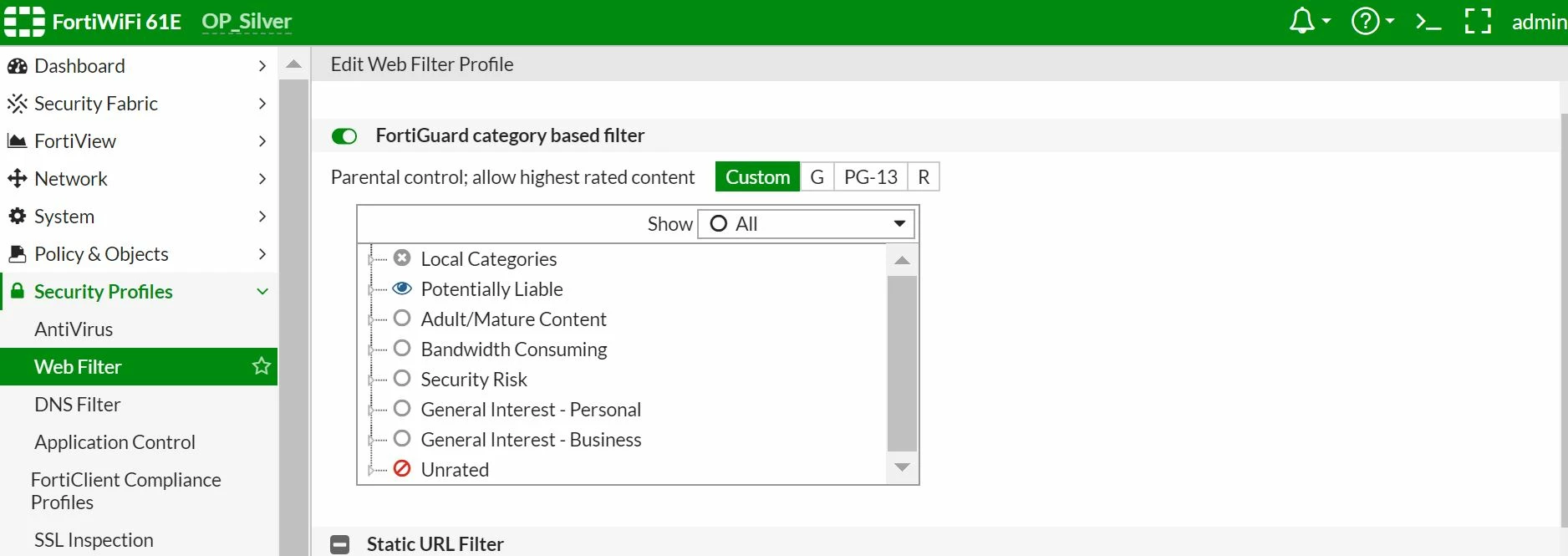

Hello.
Friends, sorry for my English, i am from Russia and English is not my hight skill)
I have FortiWiFi 61E with
Firmwarev5.6.3 build1547 (GA)ModeNAT (Flow-based)
 I can't to create 2 and more web filter profile, only modify default. I don't see buton "add". On FortiGate 300D available button "add/clone" but on 61e button is no present. How can i create more than 1 profile?
    Best answer by Sunil_Panchal_NSE7
    Brother ,
     please find the attachment system then feature accessibility ,
    then go to enable multi security feature, that 's it you r done

    Brother ,

    Thank you Bro. It realy work)
    Sorry for my stupidity, but why are hiding this function?
