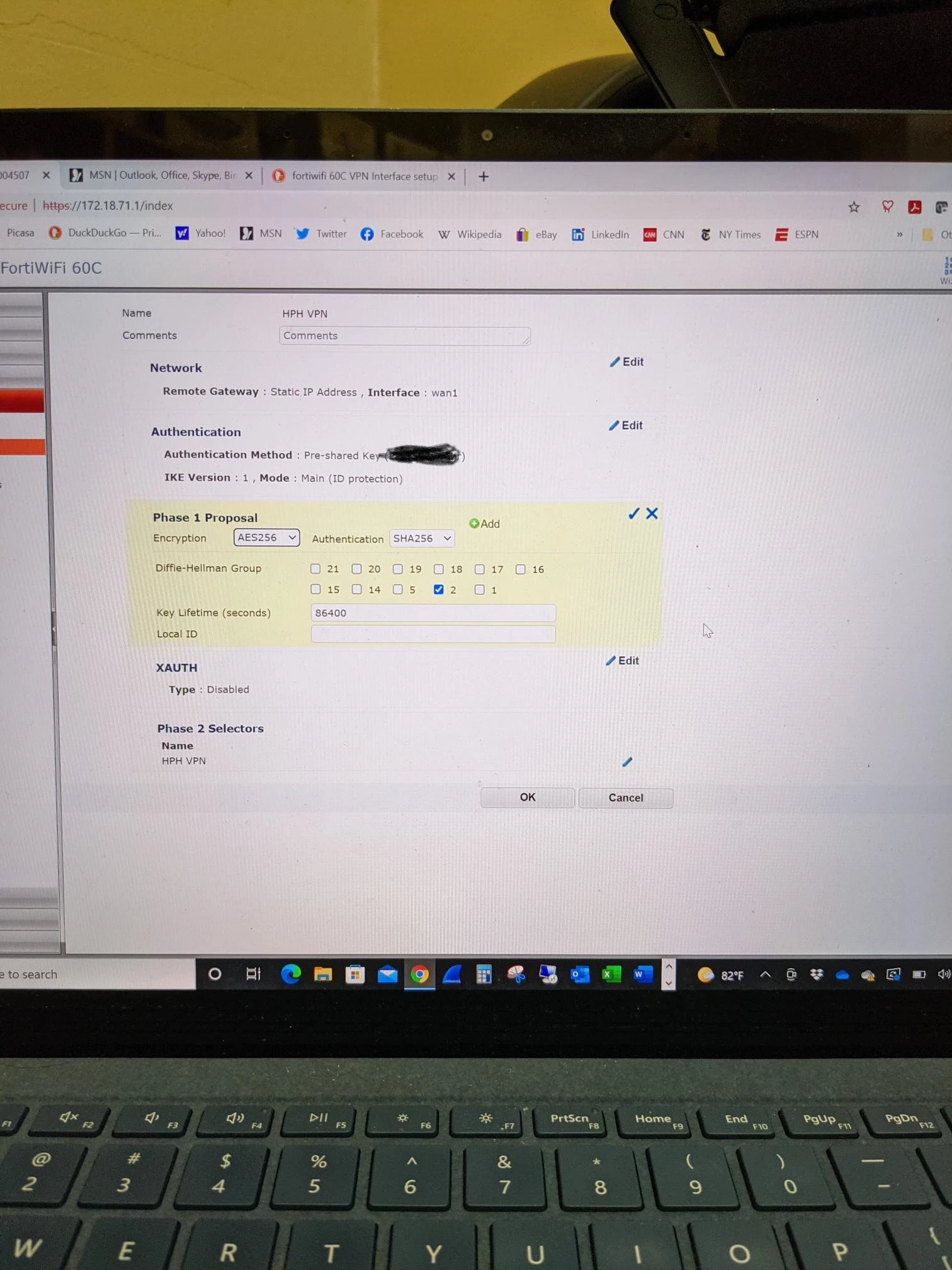

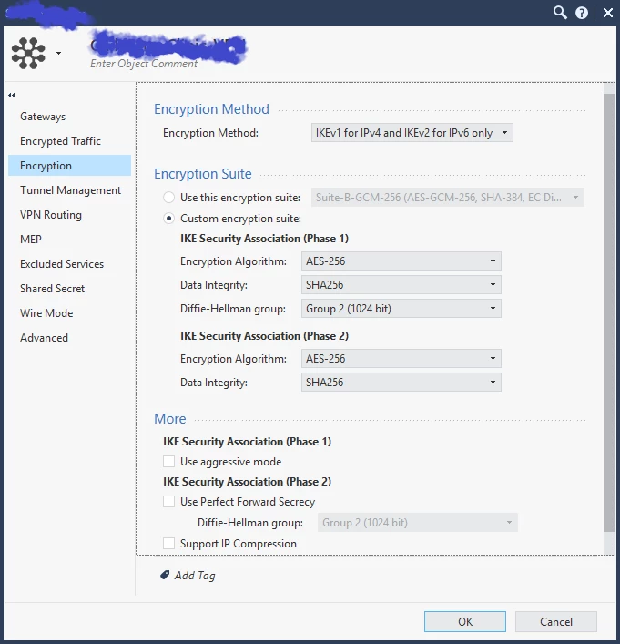

Hi All,
I am having an issue trying to get a Site-to-Site VPN up and running between a Fortiwifi 60c and a Checkpoint firewall. I have triple checked the settings and they are all correct (See images below). The first image is the checkpoint firewall and the second is the fortiwifi 60c. I am getting a phase one policy mismatch. The engineer I am working with says he doesn't see anything in his logfiles that even indicate that I am trying to connect, but I get the following in the Fortiwifi VPN logs:
date=2021-11-19 time=09:52:36 logid=0101037128 type=event subtype=vpn level=error vd="root" logdesc="progress IPsec phase 1" msg="progress IPsec phase 1" action=negotiate remip=199.253.xxx.xxx locip=67.53.xxx.xxx remport=500 locport=500 outintf="wan1" cookies="40b9e860259787fa/0000000000000000" user="N/A" group="N/A" xauthuser="N/A" xauthgroup="N/A" assignip=N/A vpntunnel="N/A" status=failure init=remote mode=main dir=inbound stage=1 role=responder result=ERROR
date=2021-11-19 time=09:52:36 logid=0101037124 type=event subtype=vpn level=error vd="root" logdesc="IPsec phase 1 error" msg="IPsec phase 1 error" action=negotiate remip=199.253.xxx.xxx locip=67.53.xxx.xxx remport=500 locport=500 outintf="wan1" cookies="40b9e860259787fa/0000000000000000" user="N/A" group="N/A" xauthuser="N/A" xauthgroup="N/A" assignip=N/A vpntunnel="N/A" status=negotiate_error reason="peer SA proposal not match local policy" peer_notif="NOT-APPLICABLE"
If anyone has any input that they think would be useful, I would appreciate it if you'd drop it below.
TIA
Don

This is a packet capture from yesterday's session. I can see that my Fortinet is connecting to the Checkpoint and the Checkpoint is responding (so there should be something in their logs). I am wondering if the AES_CBC algorithm is the mismatch?
2021-11-30 15:35:28 ike 0:HPH VPN:94717: sent IKE msg (P1_RETRANSMIT): 67.XXX.XXX.XXX:500->199.XXX.XXX.XXX:500, len=192, id=241c654fc2338a41/0000000000000000
2021-11-30 15:35:29 ike 0:HPH VPN:HPH VPN: IPsec SA connect 5 67.XXX.XXX.XXX->199.XXX.XXX.XXX:0
2021-11-30 15:35:29 ike 0:HPH VPN:HPH VPN: using existing connection
2021-11-30 15:35:29 ike 0:HPH VPN:HPH VPN: config found
2021-11-30 15:35:29 ike 0:HPH VPN: request is on the queue
2021-11-30 15:35:34 ike 0:HPH VPN:HPH VPN: IPsec SA connect 5 67.XXX.XXX.XXX->199.XXX.XXX.XXX:0
2021-11-30 15:35:34 ike 0:HPH VPN:HPH VPN: using existing connection
2021-11-30 15:35:34 ike 0:HPH VPN:HPH VPN: config found
2021-11-30 15:35:34 ike 0:HPH VPN: request is on the queue
2021-11-30 15:35:38 ike 0: comes 199.XXX.XXX.XXX:500->67.XXX.XXX.XXX:500,ifindex=5....
2021-11-30 15:35:38 ike 0: IKEv1 exchange=Identity Protection id=0e8be8e11abb8180/0000000000000000 len=152
2021-11-30 15:35:38 ike 0: in 0E8BE8E11ABB818000000000000000000110020000000000000000980D00003C00000001000000010000003001010001000000280101000080010007800E0100800200048003000180040002800B0001000C0004000151800D0000144048B7D56EBCE88525E7DE7F00D6C2D30000002CF4ED19E0C114EB516FAAAC0EE37DAF2807B4381F000000010000138D61A6D16A0000000018290000
2021-11-30 15:35:38 ike 0:0e8be8e11abb8180/0000000000000000:94718: responder: main mode get 1st message...
2021-11-30 15:35:38 ike 0:0e8be8e11abb8180/0000000000000000:94718: VID FRAGMENTATION 4048B7D56EBCE88525E7DE7F00D6C2D3
2021-11-30 15:35:38 ike 0:0e8be8e11abb8180/0000000000000000:94718: VID unknown (40): F4ED19E0C114EB516FAAAC0EE37DAF2807B4381F000000010000138D61A6...
2021-11-30 15:35:38 ike 0:0e8be8e11abb8180/0000000000000000:94718: incoming proposal:
2021-11-30 15:35:38 ike 0:0e8be8e11abb8180/0000000000000000:94718: proposal id = 0:
2021-11-30 15:35:38 ike 0:0e8be8e11abb8180/0000000000000000:94718: protocol id = ISAKMP:
2021-11-30 15:35:38 ike 0:0e8be8e11abb8180/0000000000000000:94718: trans_id = KEY_IKE.
2021-11-30 15:35:38 ike 0:0e8be8e11abb8180/0000000000000000:94718: encapsulation = IKE/none
2021-11-30 15:35:38 ike 0:0e8be8e11abb8180/0000000000000000:94718: type=OAKLEY_ENCRYPT_ALG, val=AES_CBC.
2021-11-30 15:35:38 ike 0:0e8be8e11abb8180/0000000000000000:94718: type=OAKLEY_HASH_ALG, val=SHA2_256.
2021-11-30 15:35:38 ike 0:0e8be8e11abb8180/0000000000000000:94718: type=AUTH_METHOD, val=PRESHARED_KEY.
2021-11-30 15:35:38 ike 0:0e8be8e11abb8180/0000000000000000:94718: type=OAKLEY_GROUP, val=MODP1024.
2021-11-30 15:35:38 ike 0:0e8be8e11abb8180/0000000000000000:94718: ISAKMP SA lifetime=86400
2021-11-30 15:35:38 ike 0:0e8be8e11abb8180/0000000000000000:94718: negotiation failure
2021-11-30 15:35:38 ike Negotiate ISAKMP SA Error: 2021-11-30 15:35:38 ike 0:0e8be8e11abb8180/0000000000000000:94718: no SA proposal chosen
