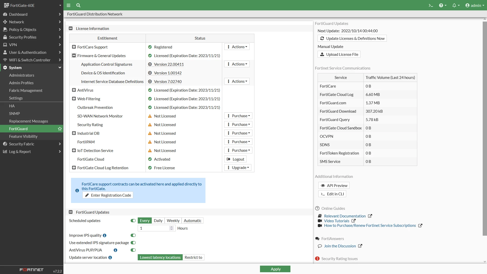

I have a FGT60E that is presenting a strange issue. I just updated OS to 7.2.2.
When I launch  Fortiview and look at the application, the application's services/application icon is no longer visible.
I have tried downgrading OS, initializing, refreshing the browser, reinstalling, etc., but it did not work.
I tried chrome Firefox edge as browsers, but none of them showed the application icon.

Make sure that the unit has active connection to FortiGuard, and check with:
diag debug app update -1
exec update-now
You can't tell if the command "diagnose web-ui app-icon-update" is working, just by changing the timeout. Also, this was removed a long time ago.
Use this guide (new commands available there):
https://community.fortinet.com/t5/FortiGate/Technical-Tip-Updating-Among-Us-logo-to-appropriate-application/ta-p/195654

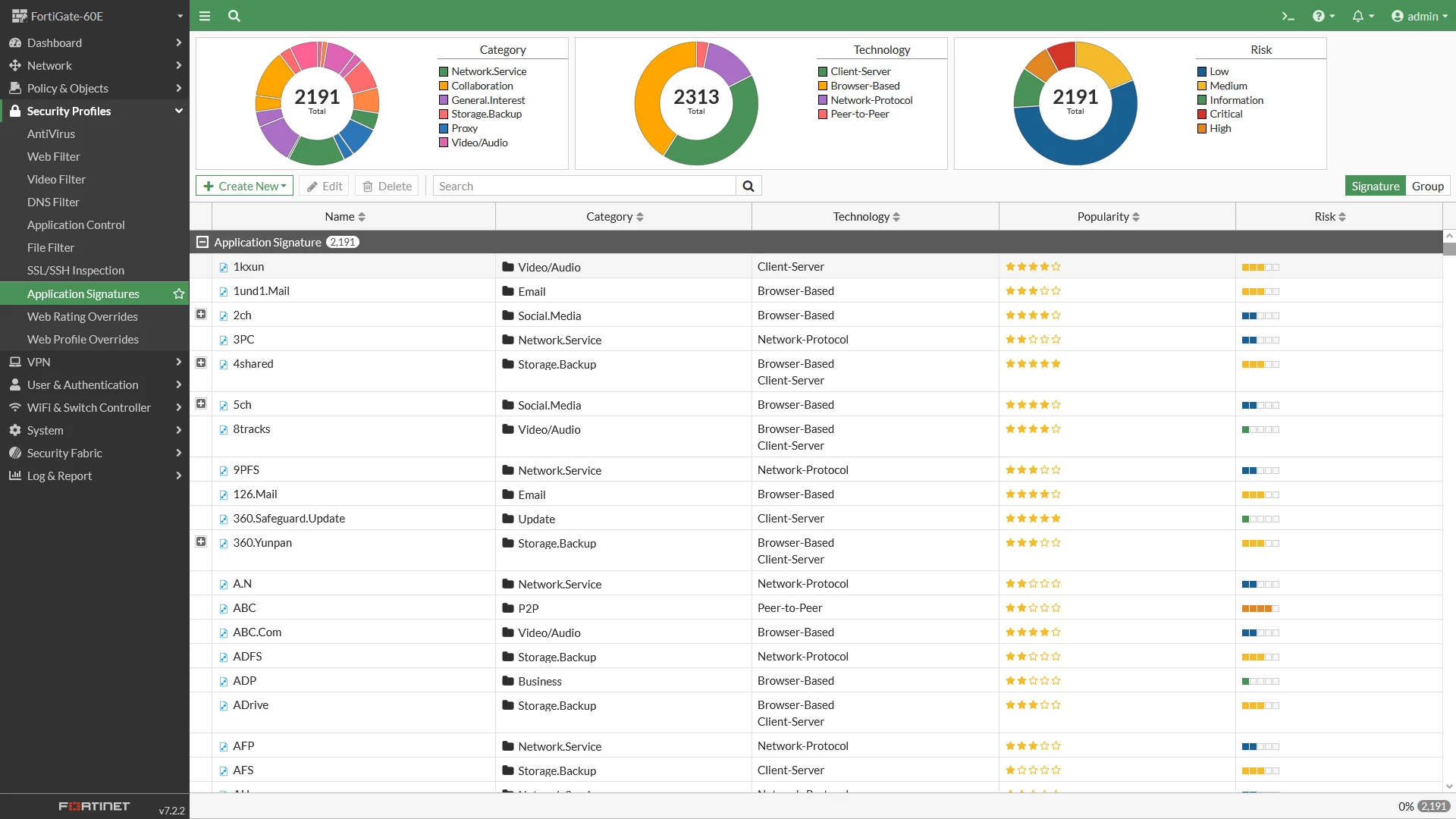

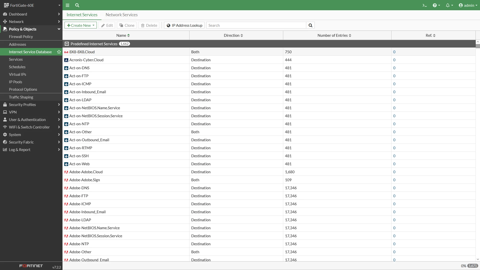

I have successfully repaired the ISDB icon with a firmware update, but the application signature icon is broken.
I tried this solution and only 6 different icons were updated.
I can update the application signature definition list to the latest, but the icons are still broken.fortiguardfortiguardbroken  application signaturebroken application signaturerestored ISDBrestored ISDB
