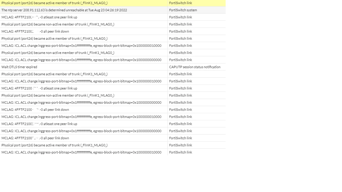

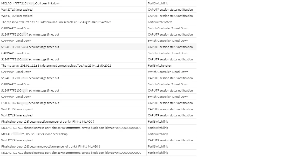

FortiSwitches are status not stable appearing onlin/offline frequentl. High CPU usage on Fortilink.
  • August 23, 2022
  • 2 replies
  • 9537 views
I have a Fortigate 601E v6.4.9 as a switch controller, with 2 FotiSwitch 1048E as MCLAG peers and multiple 124F on distribution.
Few switches suddenly went offline including 1x 1048E.
in LOGS it shows
NTP is fine.

do you really set ".ntp.org" as NTP server? the hostname part is missing.
Please post output of 'diag sys ntp status'.

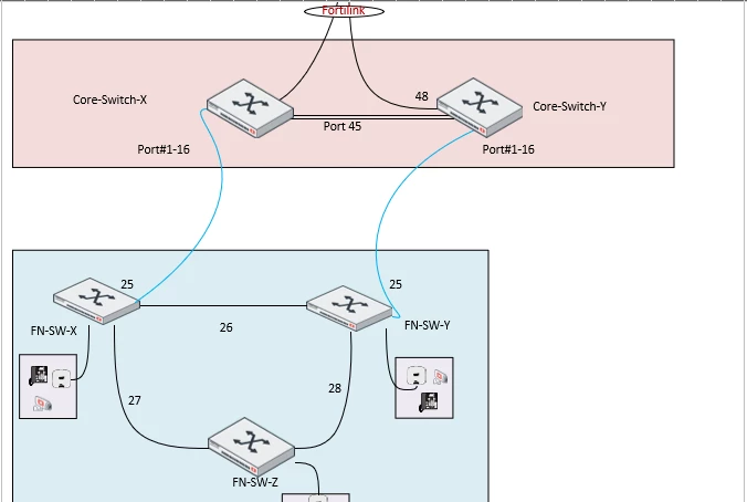

I disconnected all the Access switch from core, MCLAG-ICL wasn't enabled between core Switches (1048)
Now when connect Access switches set mclag-icl enable is not working.
Below is the what connections look like
