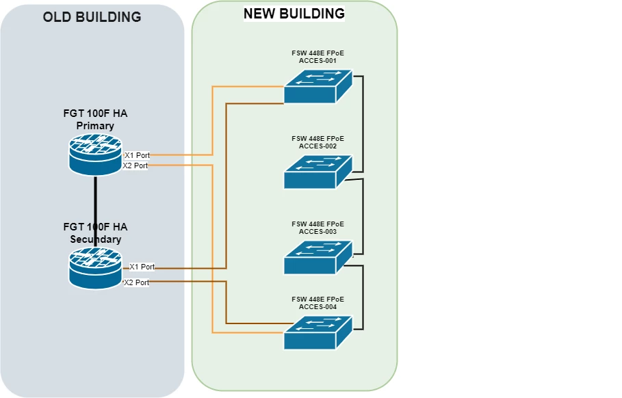

Hello there,
I need to make new connection with 4 FortiSwitches 448E FPoE and FortiGate 100F in HA cluster.
Because distance between FortiGates and FortiSwitches is over 400 meters (different buildings) and I got 8 optic fibers for this connection.
My question is what is best recommendation for connecting FortiSwitches with FortiGate to make it redundant and maximize speed of given ports.
  • In FortiGate I was thinking of use X1 and X2.
  • Also want to use FortiLink for management.
  • Nice if both links will be used.
In attachment network connection plan I was thinking off.
Any suggestion or good practice will be nice to read.

ebilcari
January 4, 2024
You can refer to the topology section on the admin guide that include practically all the possible ways when using FortiLink mode.
In this case maybe "HA-mode FortiGate units managing a stack of several FortiSwitch units" fits better or try the two-tier topology if you are able to build a distribution layer.

AEK
January 20, 2024
Hi Pieciaq
If you use X ports, 400m for 10Gb I think you are at the maximum supported by OM5 in multimode, or you are approaching it. So be careful of the distance and cable quality.

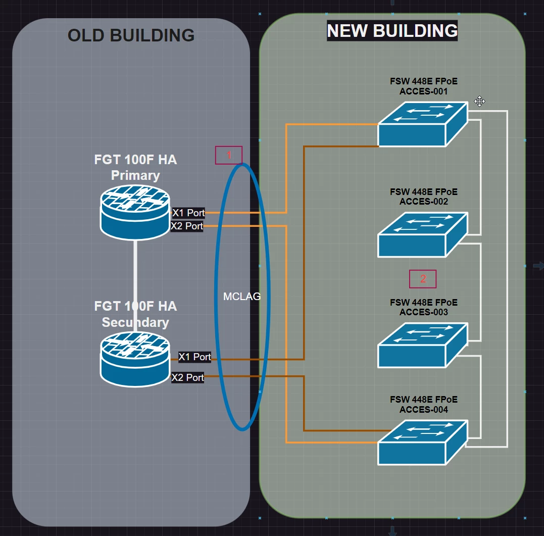

pieciaq
pieciaqAuthor
Explorer II
March 15, 2024
Thank You for for help and answers.
Make this configuration, now in testing phase all looks very promising.
When configuring this and reading tech documentation I had additional questions regarding the following configuration:
1. By using MCLAG and connecting them to two switches via ports x1 and x2 on FGT and 10 Gbit ports on FSW, will I achieve a theoretical total throughput of 20 Gbit/s? How will traffic through these two connections be routed?
2. Is it be better also to make MCLAG connection with two connection between Access-002 and Access-03 then normal link that in this configuration right now has down?
