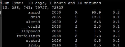

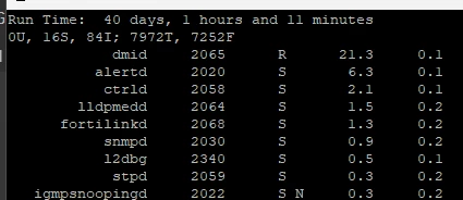

We are having issues with reading SNMP data from our 4 FS1048E switches.
Initially they were running software 7.2.something and everything was fine.
After upgrading to ver. 7.4.3 the problems started. The issue exist on all 4 of our FS1048E, but not on any of our 100/200/400 series switches
We only get partial data when polling by SNMP, and investigation shows that the SNMPD process often goes to 100% CPU, stays there for a while and then, eventually kills it self.
Upgrading to 7.4.6 has not solved the issue. With the software currently on our Fortigate, 7.4.6 is the recommended version to run.

Yes, the switches are managed by the Fortigate via Fortilink.
The SNMP requests are sent directly to the IP address of the Internal interface of the switches.
Screenshots are from the Fortiswitch CLI
