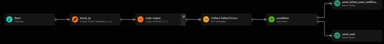

The playbook logic:
Start > block_ip > code snippet > Collect Failed Errors > Condition > Send mail notification
In all your playbook steps enable ignore errors.

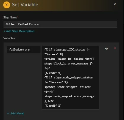

In any of your playbooks that you intend to track failed steps, include two critical steps;
(i) Set Variables Step
The above variable playbook step is Collect Failed Errors
The variable name is failed_errors - The objective is to collect failed steps errors across the playbook.
failed_errors jinja;
{% if steps.block_ip.status != "Success" %}
<p>Step 'block_ip' failed:<br>{{ steps.block_ip.error_message }}</p>
{% endif %}
{% if steps.code_snippet.status != "Success" %}
<p>Step 'code_snippet' failed:<br>{{ steps.code_snippet.error_message }}</p>
{% endif %}

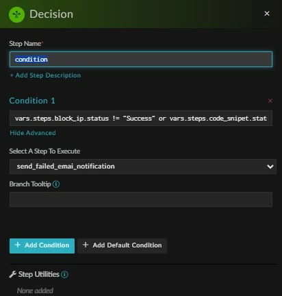

(ii) Condition Step
Fortisoar has  four step execution status; :white_heavy_check_mark: Success, :cross_mark: Failure, :warning: Skipped, :hourglass_not_done: In Progress. Our interest is on the Failure status.
To achieve this, create a two send mail steps(send_mail, and send_failed_email_notification) after the condition step and connect.
Configure the condition step and set a condition to check if the playbook steps execution status is not equal to success.
Jinja
vars.steps.get_IOC.status != "Success" or vars.steps.code_snipet.status != "Success"
If this condition is met, set the next step to execute as send_failed_email_notification otherwise the defaul condition will be all the playbooks step executed successfully and the next step is send_email.
