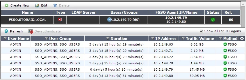

storaid
March 23, 2015
Selective wrote:
Does anyone have FSSO working with 5.2.3 ?
TEST MODEL: 200B-POE

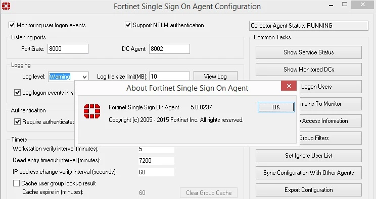

storaid
March 23, 2015
Selective wrote:
hmm, thanks, mine does not work.
What version of FSSO do you have on your server ?
latest version...

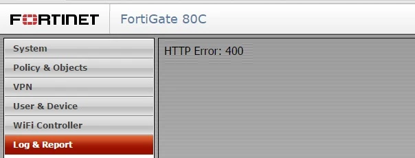

storaid
March 24, 2015
system error after a wifi interface has been removed.......
I can not go to any management console, includes CLI......
anyone have this problem????
this problem sucks...
VicAndr
March 25, 2015
You shouldn't remove WiFi interface from System > Network > Interfaces GUI section. The right way to remove it is - through WiFi Controller > WiFi Network > SSID - the same place where you created it in the first place.
I had a number of issues with WiFi Networks in the past while performing "in-place" upgrade to a major FortiOS version (i.e. 4.3 to 5.0; usually not while applying a patch on the same firmware branch). FortiOS upgrade scripts which transform FG configuration do not always work as expected and sometimes after upgrade you may have a hard time to fix and even remove a broken WiFi interface.
The best way to resolve the issue in your case would be...
