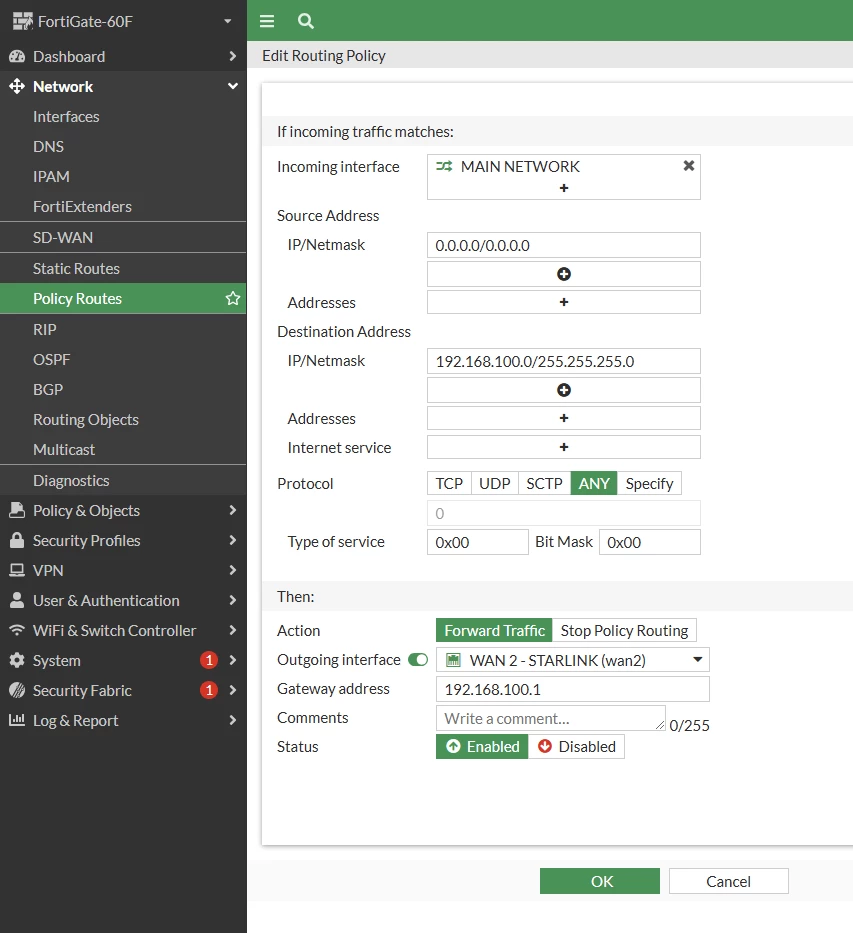

With the Peplink devices that we use, by implementing the following rule it is possible to reach the antenna via the Starlink App even if it is not activated:
- Outbound policy – ​​IP Address 192.168. 100.1 – Enforced WAN 1 (where Starlink is connected).
Installations on Yachts include an antenna, power supply and direct connection to the Fortinet WAN.
The Starlink router is not present.
I tried with a static route 192.168.100.1/255.255.255.255 but it doesn't work.
Is it possible to instruct a Fortinet so that when a user is connected via the App he can reach the antenna even if it is not active?

BMTEC
BMTECAuthor
November 22, 2024
Thanks for the tip Hatibi.
I tried to create this rule but it doesn't work.
With app I can't reach the Starlink antenna.

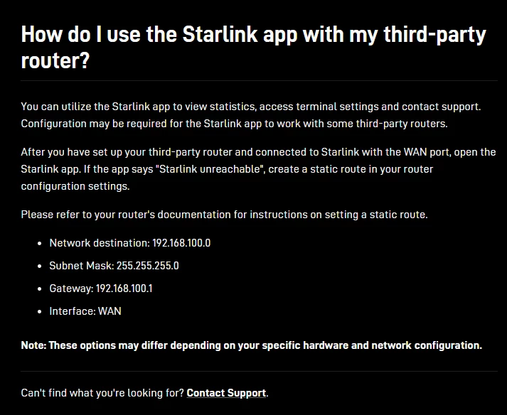

These are the directions from the Starlink website:
https://www.starlink.com/support/article/27802782-944e-10aa-bc29-23ccbc1fce73

If you check with a packet sniffer in FortiGate, is the traffic flow going out of any other interface?
