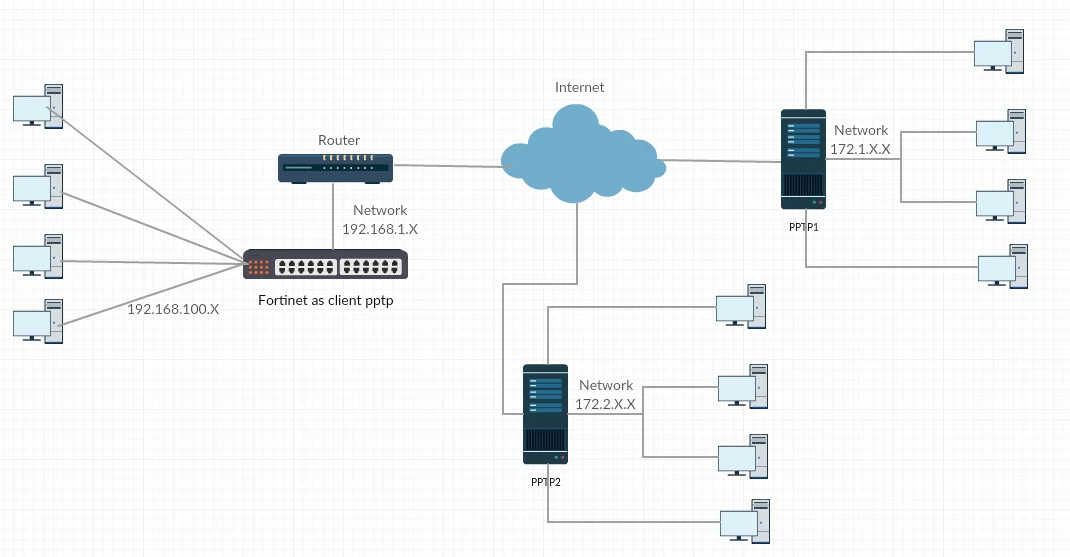

Hello, I need to connect my fortinet 60d constantly with multiple servers PPTP VPN old. What do I need to set this up?
PPTP 1 172.1.X.X/16
PPTP 2 172.2.X.X/16
I have my fortinet link to router 192.168.1.X with wan1 interface, and with interface internal i have another network 192.168.100.x. I want that from this range can access to all PTP VPN.

I haven't used the PPTP client feature yet but in my opinion you can only have one PPTP client config per VDOM. That would mean you'd have to create multiple VDOMs to access multiple PPTP servers, and link them together via inter-VDOM links.
