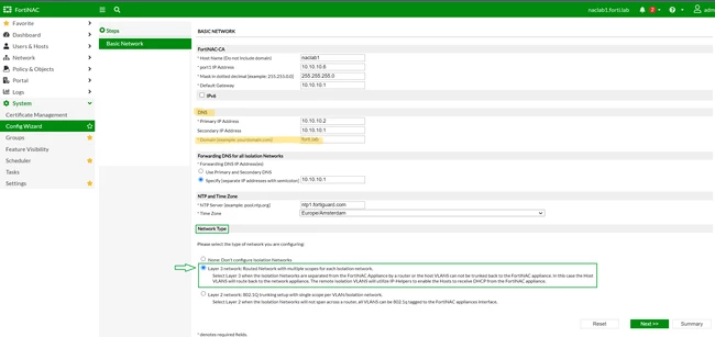

Hello NAC admins,
I would like to know which network type is recommended in FortiNAC configuration, Layer 2 or Layer 3 ? What's really difference between the two ?
Thanks in advance
BR,
Best answer by ebilcari
A Layer 2 network type can be considered when FNAC is deployed as a hardware appliance at the edge perimeter and directly connected to the switch infrastructure. This setup also supports trunking, which can simplify configuration. When FNAC is deployed as a virtual machine or as physical appliance in the data center, using a Layer 3 network becomes necessary, as the isolation VLANs should not be extended to the data center. Nevertheless, FNAC offers flexibility, and the deployment type should be chosen based on the specific network requirements.

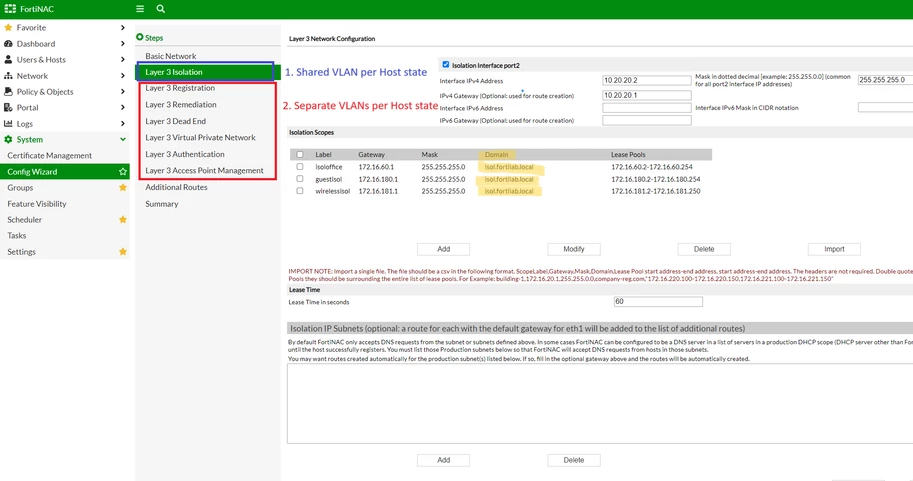

Thank you for your answer.
From that article, the Layer 3 configuration appears to be the most suitable option. I do have another question that might seem basic, my apologies in advance.
In the “Basic Network” section, specifically under the “Domain” field in the DNS configuration, does this need to be a specific domain? Additionally, can the same domain be used for the isolation VLAN? I’m a bit unclear on that part
BR,
AEK
November 2, 2025
No it can't be the same domain.
Domain: Identifies the domain for this range of IP addresses. To help identify the VLAN, incorporate part of the name in the domain.
  • Avoid using a domain already existing in the production network. Otherwise, DNS resolution may not work properly for any names using that production domain that are part of the Allowed Domains List.
  • If you use agents for OS X, iOS, and some Linux systems, using a .local suffix in Domain fields may cause communications issues.
Example:
  • Production domain is megatech.com
  • For Isolation VLAN use megatech-iso.com
  • For Registration VLAN use megatech-reg.com
Ref: https://docs.fortinet.com/document/fortinac-f/7.6.0/configuration-wizard/143459/configure-lease-pool-domain
Hope it helps.
