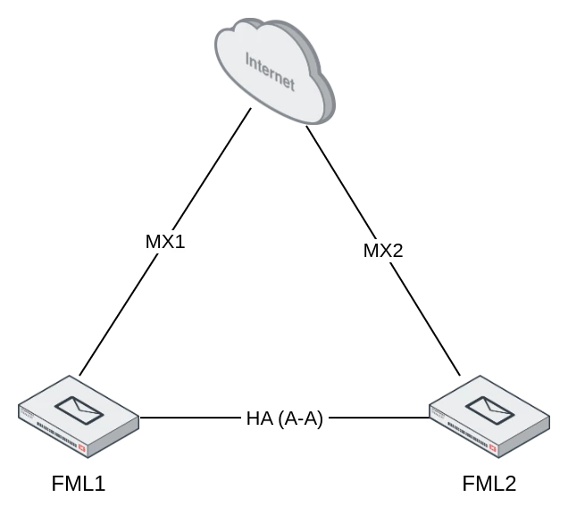

Hi CL1
No need for DNS failover. Also a Active-Passive config will put your second FML in a idle state for the whole year. So I think one good idea is to configure Active-Active mode (config sync), and configure 2 MX different entries in your public DNS.
Depending to your case, you can configure one primary MX (1st priority) and one secondary MX, or you can configure them with the same priority so the remote senders will load balance between your 2 MXs.
The failover is native to SMTP servers, it means when a remote server tries to send to your first MX, in case it finds it down then it will automatically send to the second MX.

Hello AEK,
Apologies if I'm mistaken, but what you described sounds like DNS failover, correct? Perhaps I don't fully understand the concept of DNS failover and should do more research on it. My main concern is ensuring connectivity between the two FortiMails, especially if they're separated by a significant distance, say 500km or more. The only solution I'm familiar with is MPLS VPN, which I understand is highly effective but can be quite costly. Do you have any alternative solutions to recommend?

Hi CL1
The failover here is native to mail servers, and it is not a DNS failover. It means a remote mail server will send to the first MX, and in case it is down it will send immediately to the second MX.
Your second concern is the synchronization between the two FML, right? For Active-Active there is no concern regarding the latency because it is just config sync, not data sync. See here:
https://docs.fortinet.com/document/fortimail/7.6.1/administration-guide/846008/using-high-availability-ha#About_HA_modes
Config sync doesn't not need low latency and it uses very low bandwidth. So your MPLS VPN is perfect for that in all cases.
