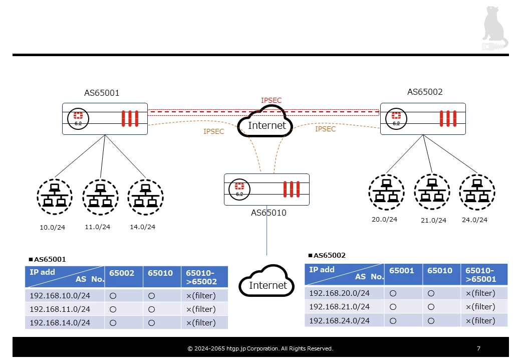

ncat.png【background】
 I'M TRYING TO CONNECT THE THREE LOCATIONS WITH IPSEC AND ROUTE THEM USING BGP.
【Prerequisite configuration】
 All locations are Fortigate 50E using OS 6.2
 - FOR A DIRECT IPSEC ROUTE WITH AS65001<->AS65002, ALL SUBORDINATE SEGMENTS ARE LISTED IN THE ROUTING TABLE.
 - IPSEC routes between AS65001<->AS65010 / AS65002<->AS65010 are also listed in the routing table for all subordinate segments.
 - When going through a AS65010 such as AS65001<->AS65010<->AS65002, routing information should not flow to AS65001 and AS65002.
【question】
 - Assuming that BGP is used for routing, what kind of settings should be made to "When routing via AS65010 such as AS65001<->AS65010<->AS65002, routing information should not flow between AS65001 and AS65002."?

You don't have to do anything special since simple triangle topology with different AS at three sites.
At AS=65001, it would get 192.168.20.0/24 from both AS=65002 and AS=65010. However, the AS path is different between them:
- AS=65002 route's AS path: 65002
- AS=65010 route's AS path: 65010 65002
Due to 4) in the route selection rules below:
https://community.fortinet.com/t5/FortiGate/Technical-Tip-BGP-route-selection-process/ta-p/195932
AS=65001 chooses AS=65002 route as the best route (shortest AS path).
The same goes with all other routes at both 65001 and 65002.
Toshi
