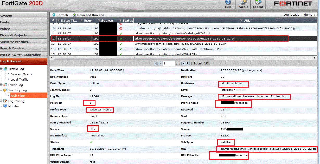

Can you clarify what you mean by passthrough? As in not hitting the firewall policy?  Have you actually applied the web filtering profile to firewall policy?  Can you post a screenshot of the firewall policy in question?  If you have a web filter profile enabled on a firewall policy, you should be able to see "drilled down" session info, similar to the following screenshot (from 5.0.9 firmware)...

Hi Dave,
Yes I can see that, Please see attached screenshot.

To be honesty, I can not tell from that firewall policy screen what does what without the column headings.  Also, not sure what the action "passthorough" means -- none of our fgt devices are on the 5.2 firmware path.

  • Web caching is enabled on the fw policy, which I suspect is what causing "grief" -- I know from 4.3.x no firewall policies are not actually hit if the requested object is stored in the cached. [strike](Perhaps this is what is meant by passthrough?)[/strike][/ol]
    Edit: documentation on passthrough action is very lacking.  I loaded 5.2 on a 200D and played around with it, I can see the usual action messages, including passthough.  I'm assuming now it's just the fgt's way of saying the event (url filter allow action) is a hit and now it will "check other web filters". See this post.[strike][/strike]
