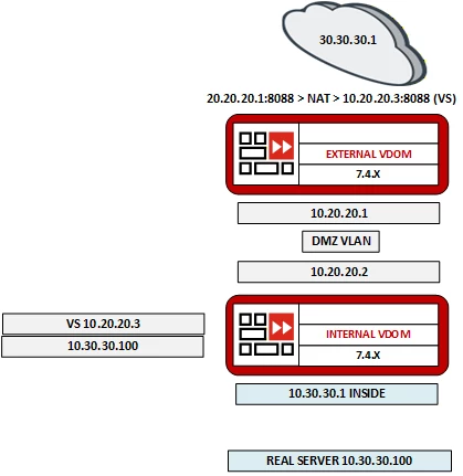

I have moved a VIP from a load balancer to an internal Fortigate as its not doing anything special, just a basic round robin.
It allows a handful of public IPs to access the Virtual Server, The setup is like this:
EXERNAL SOURCES > External VDOM > DNAT TO VS > Route to Internal VDOM > VS Configured on DMZ interface > Real Servers on Inside Interface.
It gets as far as the VS on the DMZ Interface, I can see the hits on the VS, but that it, it does not forward anything, no denies, no blocks, it just doesn't go any further that the VS? there is no health check, does it need one? it is doing SSL offload for the external certificate
Thanks

looking at the logs, the issue is at the internal VDOM, it NATs correctly to the VIP address, as its public IPs ill try and explain the Debug,
Traffic comes in from 20.20.20.20 (example) to the DNAT 30.30.30.30 external Interface and does the DNAT to the VIP and arrives at the internal VDOM, so I have eliminated the External VDOM.
On the Internal:
The result shows 0B/423B in the policy, which is odd, as thats bytes returning!
Source: 20.20.20.20, Source Port xxxx ,Source Interface: Internal-to-External
Destination: 192.168.1.100 (VS) Destination NAT IP 10.10.10.100 (Real Server) Destination port: 8088
All good!
Action: close
Policy 244 (Correct Policy)
and thats it...

Can you share a basic topology along with the debug flow collected from the Internal vdom for better understanding.
Jasys
JasysAuthor
Explorer
May 3, 2026
it is just straight forward,  Like below, I can see 30.30.301 hitting the Virtual Server, but nothing hits the real server, not even anything in the logs
