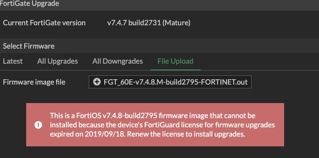

fortigate update without license

xshkurti
May 30, 2025
You can not upgrade your device without a license. When you start the upgrade process, FortiGate will contact FortiGuard services for any subscription, and if missing, the upgrade will fail.
A license is mandatory for the upgrade process.
ede_pfau
May 30, 2025
How did it get v7.4.7 on that FGT if the license has expired 6 years ago??
xshkurti
May 31, 2025
A clean install with TFTP can help you install the image. But it can not help you have the services that subscription provides: security profiles, IPS, AV, ISDB etc.
kaman
May 31, 2025
Hi AlexReviewit,
In FortiOS 7.4.2 and above, enforcement of an active FortiGate firmware license to allow firmware upgrades and downgrades has been improved. Enforcement is based on the expiry date of the current firmware license compared to the release date of the first GA release of a major version. For example, for FortiOS 7.4.x firmware upgrades, enforcement is based on the expiry date of the current support contract compared to the release date of FortiOS 7.4.0 GA.
Therefore, upgrades and downgrades between major, minor, and patch versions are only allowed if the firmware license is valid relative to the release date of the first GA release of a major version. If the firmware license expiry date is earlier than the firmware first GA major release date, then the firmware update to that version will not be allowed.
You need to buy a support contract. You are not entitled to upgrades without one.
Please refer to the documents below for more information:
https://docs.fortinet.com/document/fortigate/7.4.0/new-features/107956/prevent-firmware-upgrade-depending-on-the-current-firmware-licenses-expiration-date-7-4-2
https://docs.fortinet.com/document/fortigate/7.4.2/administration-guide/299518/preventing-fortigates-with-an-expired-support-contract-from-upgrading-to-a-major-or-minor-firmware-release-new
