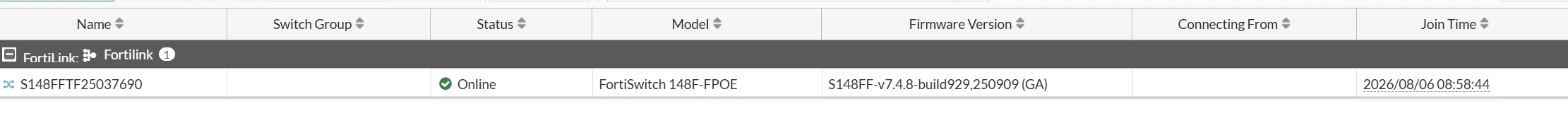

The FortiSwitches appear under Managed FortiSwitches. I can see the firmware version, status, and join time, but I cannot SSH into the switches from the GUI. It also does not show the Connecting From status or the switch IP address.

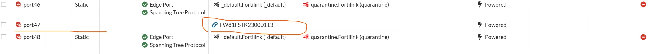

Under FortiSwitch Ports, the port connecting the FortiGate and the FortiSwitch shows as down. When I assign a VLAN to a FortiSwitch port, the VLAN assignment is accepted, but it does not actually take effect on the connected device.

FortiWiFi-81F-2R-3G4G-DSL (root) # execute switch-controller get-conn-status
Managed-devices in current vdom root:
FortiLink interface : Fortilink
SWITCH-ID                             VERSION           STATUS         FLAG   ADDRESS              JOIN-TIME            SERIAL
S148FFTF25037690                      v7.4.8 (929)      Authorized/Down 2                    N/A                         S148FFTF25037690
         Flags: C=config sync, U=upgrading, S=staged, D=delayed reboot pending, E=config sync error, 2=L2, 3=L3, V=VXLAN, T=tunnel, X=External
         Managed-Switches: 1 (UP: 0 DOWN: 1 MAX: 24)

Switch port to the fortigate:
SW2 (port47) # show full-configuration
config switch physical-port
    edit "port47"
        set cdp-status disable
        set lldp-profile "default-auto-isl"
        set poe-status enable
        set status up
