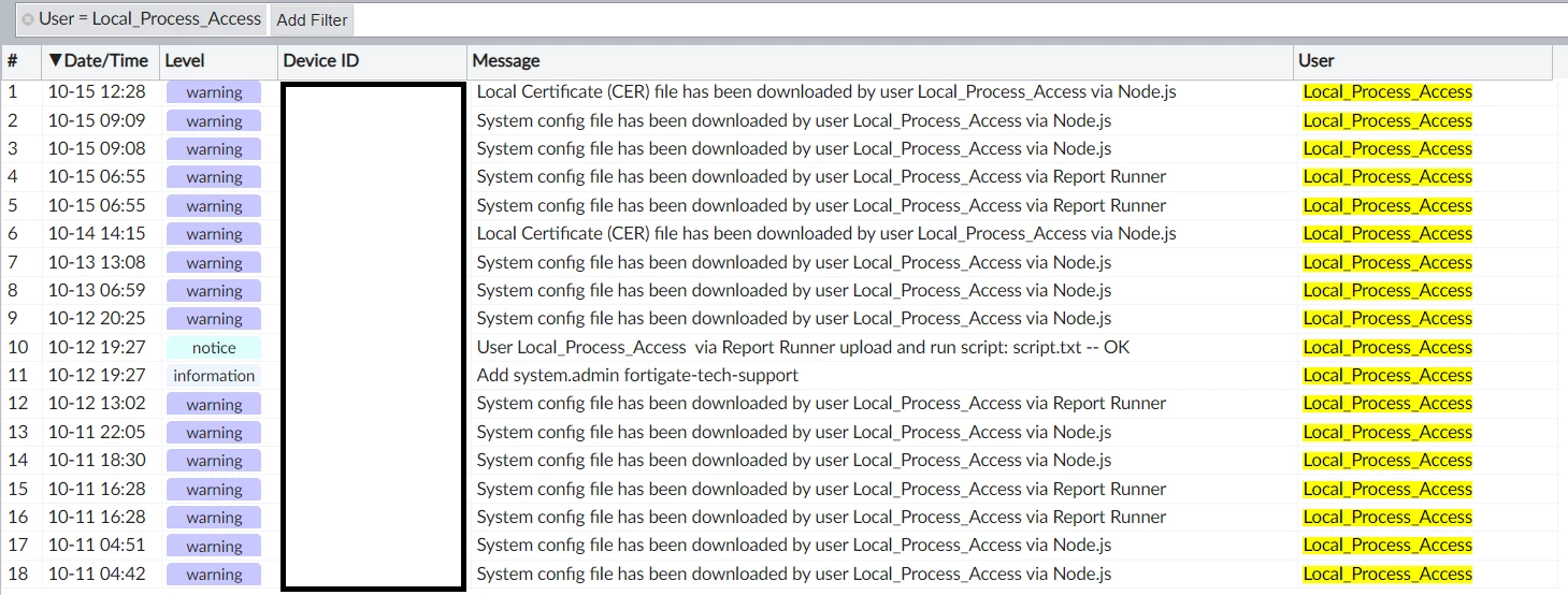

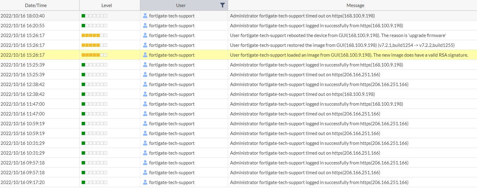

Hi,
a strange thing happened to me today.

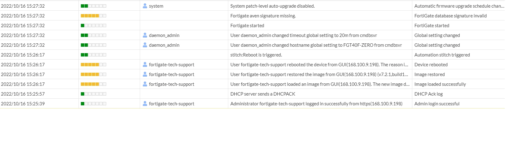

My home firewall 40F (7.2.1) rebooted unexpectedly.
I looked in the log and found that the reboot was done by the user "fortigate-tech-support" and the reason was a firmware upgrade (7.2.1->7.2.2)
In system/Administrator this user was created and I don't know about it.
My admin password is set to 17 characters (including special characters) and another administrator has an equally strong password.
FortiGate is added to FortiCloud.
Passwords remained unchanged, all configuration looks ok.
How should I explain it? I'm assuming it's not a trusted event... or is it something to do with the new CVE?
Thank you.

Ok,
according to this it is exactly the CVE problem - https://www.fortiguard.com/psirt/FG-IR-22-377
What are the best practices for this (other than upgrading to a patched version)?
Besides the user "fortigate-tech-support" that I deleted, is there anything else to watch out for? I checked the configuration several times (using PSpad) and found nothing out of the ordinary.

If you see "fortigate-tech-support" or have device with logs (type="event" subtype="system") and any of following properties:
user="Local_Process_Access"
ui="Node.js"
then open a technical ticket of Fortinet's Support for further steps and checks.
