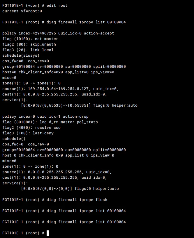

Great finding the workaround. Can you collect "diagnose firewall iprope list 00100004 " during the issue state /before flushing the iprope table and then collect same command after the fix?
We can check if there is any changes to the policies and then investigate further.

I eran the list and then the flush. From the image below it looks like I don't get anything from that list command after flushing.

It should be mentioned that the "diagnose firewall iprope flush" command is a hidden command for reasons. It will wipe _all_ policies from the fortigate and leave the iprope table empty. The FortigGate will not have any rules anymore, neither implict nor firewall, proxy or local in policies and will basically act as a router.
This command should not be used on a production firewall unless recommended by support in very rare cases.
It is absolutely not recommended to run it periodically in a script.
