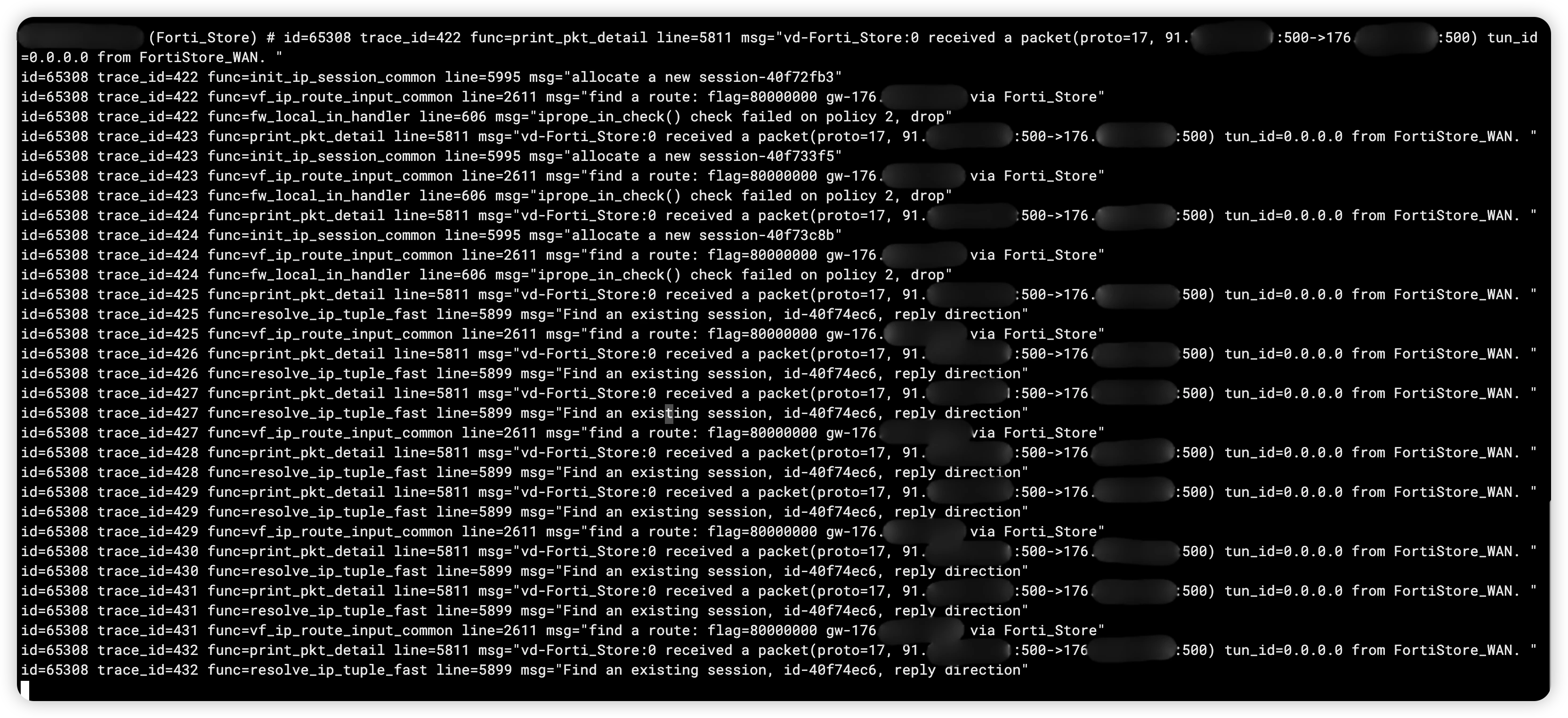

According to the packet flow trace (diagnose debug flow):
  1. Initially, when the unauthorized IP (91.x.x.x) sends a packet, the local-in-policy successfully drops it under Policy ID 2: iprope_in_check() check failed on policy 2, drop
  2. However, shortly after, the HQ FortiGate itself initiates or responds by looking for an existing session and sending outbound traffic to the remote peer: resolve_ip_tuple_fast line=5899 msg="Find an existing session, id-40f74ec6, reply direction"
  3. Because this becomes a self-originated outbound request from the FortiGate, it bypasses the local-in-policy (which only filters inbound traffic to the box), allowing the tunnel to establish.

Not sure when exactly the local-in-policy kicks in after packets hit the physical incoming port. But if you’re not specifying the physical port (NOT the phase1-interface) in “set intf” in the local-in policies, it might not work as you expect. Or at least that’s the first thing I would suspect and test.

About 2–3 hours after applying this local-in-policy, I had a scheduled firmware upgrade from version 7.2.11 to 7.4.12. After completing the upgrade, the local-in-policy started working as expected and is functioning correctly now.
