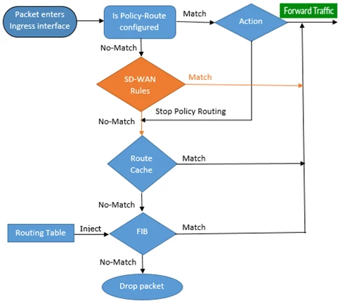

Hi,
I've found the following technical tips on how route lookup is handled in FortiGate
https://community.fortinet.com/t5/FortiGate/Technical-Tip-Routing-in-FortiGate-route-lookup-process/ta-p/194047?externalID=FD50169
But I don't think this logic applies in my case.
I've an ipsec remote access VPN, the forticlient initiates the communication with the FGT (my VPN gateway), the FGT receives requests from forticlient on port1, but it sends the responses on port2 (because of an SDWAN rule I have), And I never get the response on my forticlient (I get a connection timeout on the FGT). I can't modify my SDWAN rule, so I've tried to twist this behavior by adding a PBR so that packets coming on port1 are always returned from that same port. The PBR I added never matched, that's why i want to know if Fortigate takes into consideration PBR entries when doing a route lookup for local out traffic
