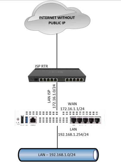

Hello everyone I need help. Let me explain you. On past customers have IP public and from my office I monitor and have remote access on fortigate.  now he changed he have always internet but without ip public how can I continue de have remote access to fortigate and monitor it. Waiting for you plse :pensive_face::pensive_face:.
PS: port forwarding is option from ISPdont give me this possibility.

March 17, 2022
Ok ede. but in this case what ip i must use like remote gateway on forticlient.  below overview of my design i use one ip of lan isp like gateway on my fortigate

for IPSec or SSLVPN to FortiGate, you will need a public IP or hostname to connect to, if FortiGate should be receiving the connection attempt.
In your case, you would need to set up something on your ISP router (where the actual internet breakout is) to forward connections to a specific port/IP/hostname through to FortiGate, but you mentioned this is not an option, correct?
If you  have a different VPN server (with a public IP), FortiGate could initiate a connection to it (as a spoke, essentially), and you could reach FortiGate through that other VPN server.
But:
- either, you must make FortiGate reachable from internet somehow (DDNS, port forwarding)
- or FortiGate must establish a connection to a different VPN gateway to which you can also connect, and reach FortiGate through that
