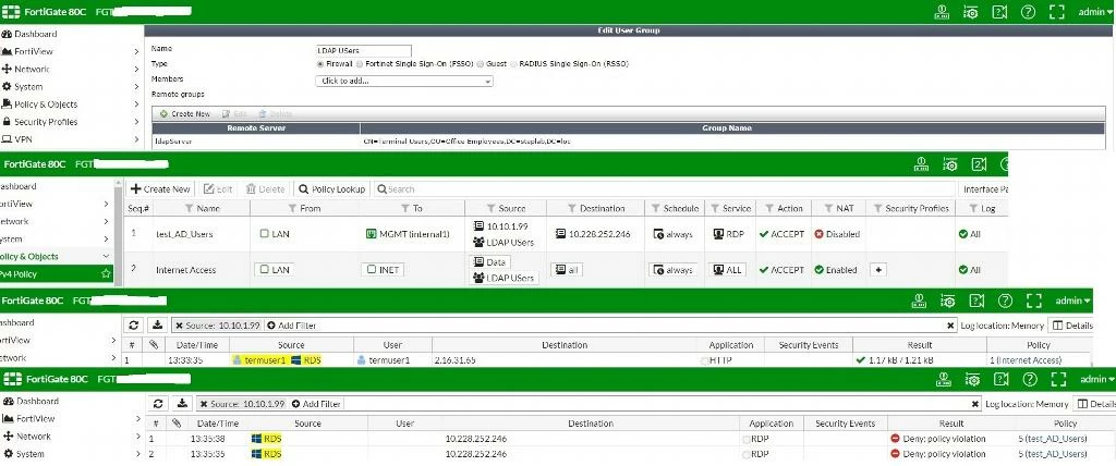

Hi, We have configured LDAP Server in our Fgate80C and added Firewall User Group with Remote Groups. We have Identity based 2 Security policies allowing this user group to access internet and terminal server by RDP. Internet access policy works well, with authentication page appearing. But TS access policy doesn't work. Firmware version is 5.4.3.  What would you suggest?
Thank You.

    With agent-based and polling mode  FSSO  everything is well. But without FSSO Firewall User Group with Remote Group doesn't identify users when they try to access TS by RDP. If users are authenticated  for internet access by policy seq #2, after that they are able to initiate RDP Session.

    - if user tried Web page, went through HTTP/HTTP, he get authenticated through basic auth popup in web page
    - if he is previously authenticated because of web access, then he can reach TS through identity-based policy #2
    - if he attempt TS access via RDP first, and so he is unknown to firewall, he fail. How would you like to present user with firewall authentication pop-up (as for HTTP) when he used RDP protocol ?
    That's why I tried to promote FSSO, because user will be, most probably, known to firewall long before he will try to access resources via protocols like RDP that are not that suited/adopted to additional authentication as HTTP.
