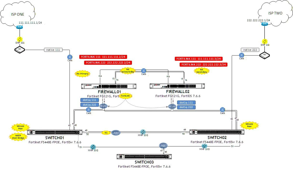

Hi. Does anybody have an opinion about FortiGate appliances setup in a design where all routing is between sub-interfaces on the Fortilink interface? I call this a "FortiGate-on-a-Stick" design.
I am considering the ISP connections for a new install consisting of three FS448E switches in a FortiLink design with two FG121G appliances in HA mode. I will use Vlan sub-interfaces on the FortiLink interface for two ISP DIA circuits as well as Vlans in my LAN.
FortiGates-on-a-Stick designFortiGates-on-a-Stick design
Is this a bad idea? Is FortiLink stable enough for this design to be reliable? Does FortiOS prefer to separate Inside and Outside on different physical interfaces for NAT and SDWAN features?

Hi Tony
The design looks safe and secure as long as you keep patched. For example if there is a new vulnerability in FortiSwitch/FortiLink then the attacker may easily find himself in the internal network.
But in real word it depends of the design is for which kind of company. For example a bank, a telecom operator or other serious company never do so, while smaller companies may accept it as it is low budget.
You may also look from security standards side, they probably don't recommend it.
