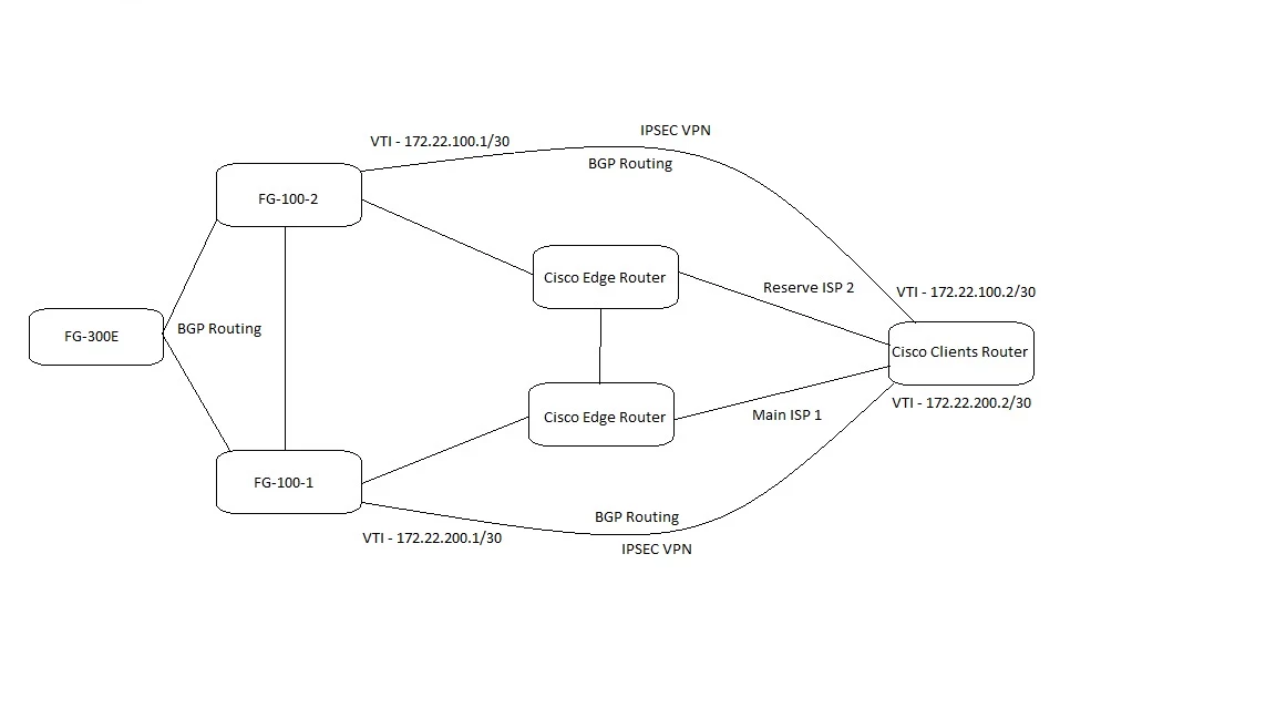

Hello everybody! Sorry for my english. I have 2 FG-100E. First - 7.04 firmware, second - 7.2.1. Each has a separate ISP and IPSEC VPN tunnel with the client. BGP is configured with the client via VTI on each FG-100. IPsec is terminated on loopback interfaces. When the tunnel down on the first FG-100, the traffic is switched via BGP to another FG-100 via another ISP.
I use asymmetric routing to save the application session when switching between FG-100.
The problem is that when traffic switches to second fortigate, AСK packets from the client are dropped. I don't watch them with a sniffer. BUT outgoing packets via tunnel reach the client.  If the client re-create the session and sends SYN, then it starts working normally аnd I'm watching the incoming packets with a sniffer.

mstoy
mstoyAuthor
August 29, 2022
Hi Tthrilok, thanks for the reply!
Yes, session initiate from the first firewall.
When traffic moves to the second fortigate it really doesn't know about the session.
So I use the asymmetric routing option.
config system settings
    set asymroute enable
I expect if a non-syn packet arrives at the second fortigate then it will pass according to the routing table, without establishing a session and without checking the firewall rules
As described in the article:
https://community.fortinet.com/t5/FortiGate/Technical-Note-How-the-FortiGate-behaves-when-asymmetric-routing/ta-p/198575?externalID=FD39943
Asymmetric routing is also enabled on first firewall.
There are no IPS, antivirus, or other security options on these firewalls. So I use them partly as routers.
I turn on "debug flow" and "debug sniffer" and I don't understand why I don't see packages other than SYN.
