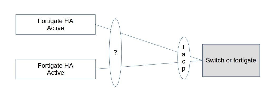

I’m trying to setup LACP between Fortigate HA Active-Active cluster and another device (switch or another fortigate). On Fortigate HA, only one link to the primary is active and passing traffic.
There is documentation for HA Active-Passive to prevent sending traffic to the slave(“set lacp-ha-secondary enable” ).
Is there any m-lag configuration option on Fortigate HA ?.

Thanks, have already seen this. I’m interested in lacp from single fortigate to fortigate HA(Active-Active). The document says the switch need to support m-lag.
With default LACP setting, only one link is active on Fortigate HA(Active-Active) and that too to the Primary, which defeat the purpose of Active-Active.
LACP status on Single Fortigate to Fortigate HA(Secondary).
link status: up
LACP state: negotiating
LACPDUs RX/TX: 24/34
actor state: ASAODD
actor port number/key/priority: 1 33 255
partner state: ASAIDD
partner port number/key/priority: 1 33 255
aggregator ID: 1
RX state: CURRENT 6
MUX state: WAITING 2
I’m not aware of fortigate supporting anything other than 802.3ad aggregate.
thanks,
funkylicious
July 8, 2026
based on my understanding of how it works ( HA A/A ) you cannot form a single LACP with 2 distinct FGT to a switch since they are not treated as a single unit, but rather go the classical way of LACP with each FGT it’s own LAG.
the traffic will always reach the PRI and it will distribute the packets accordingly
