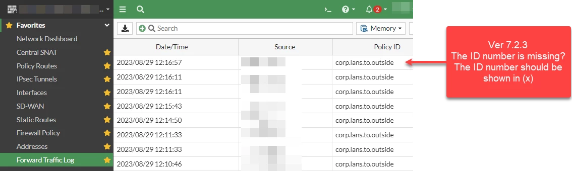

Fortigate Forward Traffic Log not showing Policy ID Number (x)
  • August 29, 2023
  • 9 replies
  • 5717 views
Ver 7.2.3 see pic below

spoojary
August 29, 2023
Have you tried upgrading the firmware. This can be a known issue on the firmware. Also it is recommended to go to the latest version of the FGT.
what is the FGT model ?

Model name: FortiGate-80F
Yes I have the same issue on 7.2.5
Mrinmoy
August 29, 2023
What if you select the log and click on details? ID number is showing there?

August 30, 2023
It is not in details either
Mrinmoy
August 30, 2023
Seems like it is a bug. To be more sure you can try to upgrade it to 7.4.0, otherwise you can create a support ticket for bug identification.
Mrinmoy
August 30, 2023
I will also try to reproduce it in my LAB. I will keep you posted.
Mrinmoy
August 30, 2023
Also if possible, share here a row log entry in txt format.

srajeswaran
August 30, 2023
You are hitting known issues 861893 . The fix is available from 7.4.0 and 7.2.6.
861893
In Forward Traffic logs, the Policy ID column is blank.
https://docs.fortinet.com/document/fortigate/7.4.0/fortios-release-notes/289806/resolved-issues
