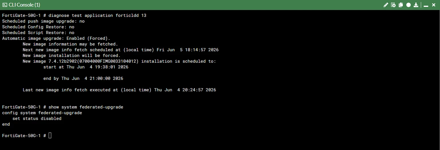

Diagnose log:
[989] fds_load_upg_matrix_map_img_id: Same major.minor: Patch 11 leads to Patch 12
[999] fds_load_upg_matrix_map_img_id: Auto-upg chooses patch 7.4.12 (b2902)
[1002] fds_load_upg_matrix_map_img_id: This upgrade will not be forced upgrade
[989] fds_load_upg_matrix_map_img_id: Same major.minor: Patch 10 leads to Patch 12
[1013] fds_load_upg_matrix_map_img_id: Auto-upgrade has chosen image id:07004000FIMG0033104012
[1014] fds_load_upg_matrix_map_img_id: Auto-upgrade path: v7.4.11(b2878) -> v7.4.12(b2902),
[906] fds_auto_upg_path_preview: Auto-upgrade path overview:
[908] fds_auto_upg_path_preview: 7.4.11 --> 7.4.12
[1020] fds_load_upg_matrix_map_img_id: This upgrade will not be forced upgrade
[3051] tsk_send_image_list: num=12
[527] fds_send_reply: Sending 824 bytes data.
[471] fds_free_tsk: cmd=1; req.noreply=1
[471] fds_free_tsk: cmd=1; req.noreply=0
[3551] fds_handle_request: Received cmd 2 from pid-17789, len 257
[37] fds_queue_task: req-2 is added to fds-update
[614] fds_https_start_server: server: 173.243.140.6:443
[615] fds_https_start_server: source-ip: 0.0.0.0:0
[119] __ssl_cert_ctx_load: Added cert FGT50G*********, root ca Fortinet_CA, idx 0 (default)
[500] ssl_ctx_use_builtin_store: Loaded Fortinet Trusted Certs
[520] ssl_ctx_use_builtin_store: Enable CRL checking.
[527] ssl_ctx_use_builtin_store: Enable OCSP Stapling.
[843] ssl_ctx_create_new: SSL CTX is created
[870] ssl_new: SSL object is created
[93] https_create: proxy server 0.0.0.0 port:0
[241] forticldd_add_hostname_check: Add hostname checking 'globalupdate.fortinet.net'
[592] __tcps_tcp_start_connect: sockfd=11, server=173.243.140.6:443, use_harelay=0, use_proxy=0
[596] __tcps_tcp_start_connect: ret=-1
[601] __tcps_tcp_start_connect: errno=115(Operation now in progress)
[888] tcps_connect: 173.243.140.6:443 -- ret 0, state 0x0(Intialized) -> 0x11(Connecting)
[888] tcps_connect: 173.243.140.6:443 -- ret 0, state 0x11(Connecting) -> 0x12(SSL-Connecting)
[888] tcps_connect: 173.243.140.6:443 -- ret 1, state 0x12(SSL-Connecting) -> 0x12(SSL-Connecting)
[350] __ssl_crl_verify_cb: CRL not found. Depth 0
[402] __bio_mem_dump: OCSP status good
[773] __tcps_ssl_connect: SSL connected.
[888] tcps_connect: 173.243.140.6:443 -- ret 0, state 0x12(SSL-Connecting) -> 0x5(Established)
[507] fds_https_connect: https_connect(173.243.140.6:443) is established.
[300] fds_svr_default_on_established: fds-update has connected to ip=173.243.140.6:443
[307] fds_svr_default_on_established: server-fds-update handles cmd-2
[1385] img_untar_req: image=[07004000FIMG0033104012], outfile=[/var/log/federated_upgrade/FGT50G*********-7-4-12.img]
[160] fds_pack_objects: number of objects: 1
[130] fds_print_msg: FCPC: len=161
[137] fds_print_msg: Protocol=2.0
[137] fds_print_msg: Command=SelectiveUpdate
[137] fds_print_msg: Firmware=FGT50G-FW-7.04-2878
[137] fds_print_msg: SerialNumber=FGT50G*********
[137] fds_print_msg: PhysicalSN=FGT50G*********
[137] fds_print_msg: DataItem=07004000FIMG0033104012
[130] fds_print_msg: http req: len=264
[137] fds_print_msg: POST https://173.243.140.6:443/FCPService/FirmwareUpgrade HTTP/1.1
[137] fds_print_msg: User-Agent: Mozilla/4.0 (compatible; MSIE 6.0; Windows NT 5.1)
[137] fds_print_msg: Host: 173.243.140.6:443
[137] fds_print_msg: Cache-Control: no-cache
[137] fds_print_msg: Connection: close
[137] fds_print_msg: Content-Type: application/octet-stream
[137] fds_print_msg: Content-Length: 353
[511] fds_https_connect: http request to 173.243.140.6:443: header=264, ext=353.
[245] fds_https_send: sent 264 bytes: pos=0, len=264
[252] fds_https_send: 173.243.140.6:443: sent 264 byte header, now send 353-byte body
[245] fds_https_send: sent 353 bytes: pos=0, len=353
[260] fds_https_send: sent the entire request to server: 173.243.140.6:443
[285] fds_https_recv: no data is available
[296] fds_https_recv: read 15 bytes: pos=15, buf_len=8192
[296] fds_https_recv: read 2 bytes: pos=17, buf_len=8192
[296] fds_https_recv: read 40 bytes: pos=57, buf_len=8192
[296] fds_https_recv: read 21 bytes: pos=78, buf_len=8192
[296] fds_https_recv: read 19 bytes: pos=97, buf_len=8192
[296] fds_https_recv: read 2 bytes: pos=99, buf_len=8192
[318] fds_https_recv: received the header from server: 173.243.140.6:443, [HTTP/1.1 200 OK
Content-Type: application/otect-stream
Content-Length: 368
Connection: Close]
[391] fds_https_recv: server: 173.243.140.6:443, buf_len=368, pos=0
[296] fds_https_recv: read 368 bytes: pos=368, buf_len=368
[406] fds_https_recv: Read all content in no_unpack mode.buf_len=368, pos=368, content_read 368 == content_length 368
[667] fds_https_stop_server: 173.243.140.6:443
[212] __ssl_data_ctx_free: Done
[1123] ssl_free: Done
[204] __ssl_cert_ctx_free: Done
[1133] ssl_ctx_free: Done
[1114] ssl_disconnect: Shutdown
[333] fds_svr_default_on_response: server-fds-update handles cmd-2
[1595] sg_parse_res: content_read=0, new=368, total=368
[1646] sg_parse_res: FCPR:Protocol=2.0|Response=401|Firmware=FDS010-FW-1.00-001|SerialNumber=FPT-FGT-DELL0708|Server=FDSG|Persistent=false|Geolocation=KMG-APAC|Respons
eItem=07004000FIMG00331:401
[130] fds_print_msg: fcpr:  len=168
[137] fds_print_msg: Response=401
[137] fds_print_msg: Firmware=FDS010-FW-1.00-001
[137] fds_print_msg: SerialNumber=FPT-FGT-DELL0708
[137] fds_print_msg: Server=FDSG
[137] fds_print_msg: Persistent=false
[137] fds_print_msg: Geolocation=KMG-APAC
[137] fds_print_msg: ResponseItem=07004000FIMG00331:401
[1648] sg_parse_res: Wrong FCPR code

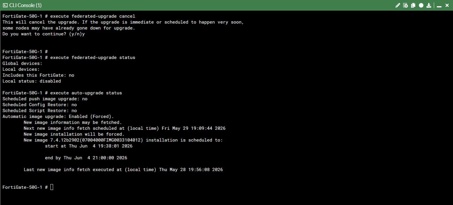

i cancelled the federated-upgrade but the schedule still unchanged,
any solutions to perform upgrade instead of cancel the upgrade?

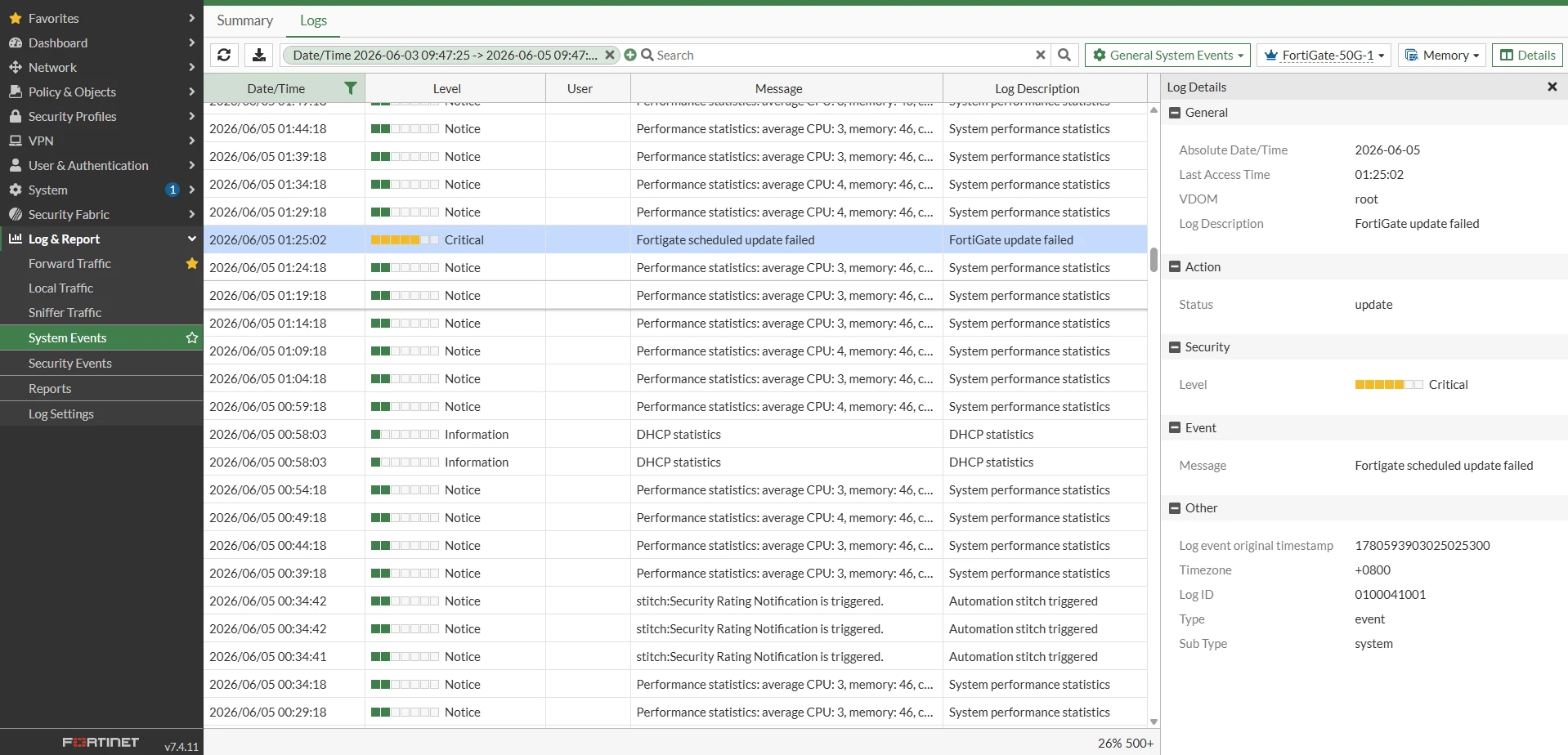

The scheduled firmware update failed again during an unscheduled window.
Could you please confirm if this device is eligible to update to the latest 7.4.x minor release while the support license is expired?
I have attached the device logs for your review. Please let me know the next steps to resolve the update failure.
