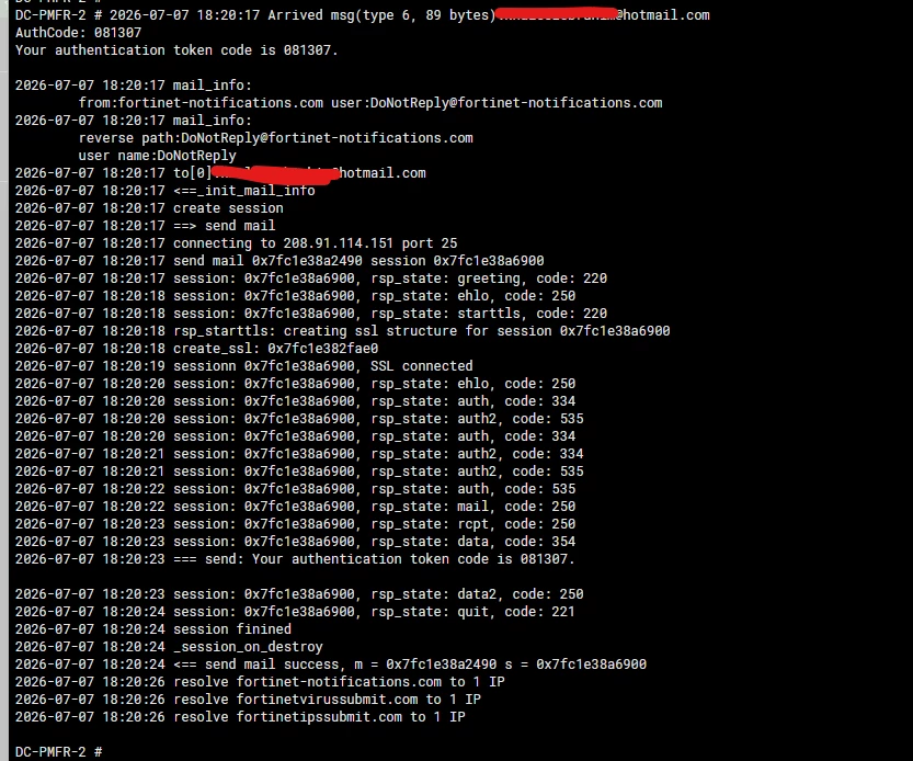

From the logs general system events also i can see  Two-factor authentication code sent.

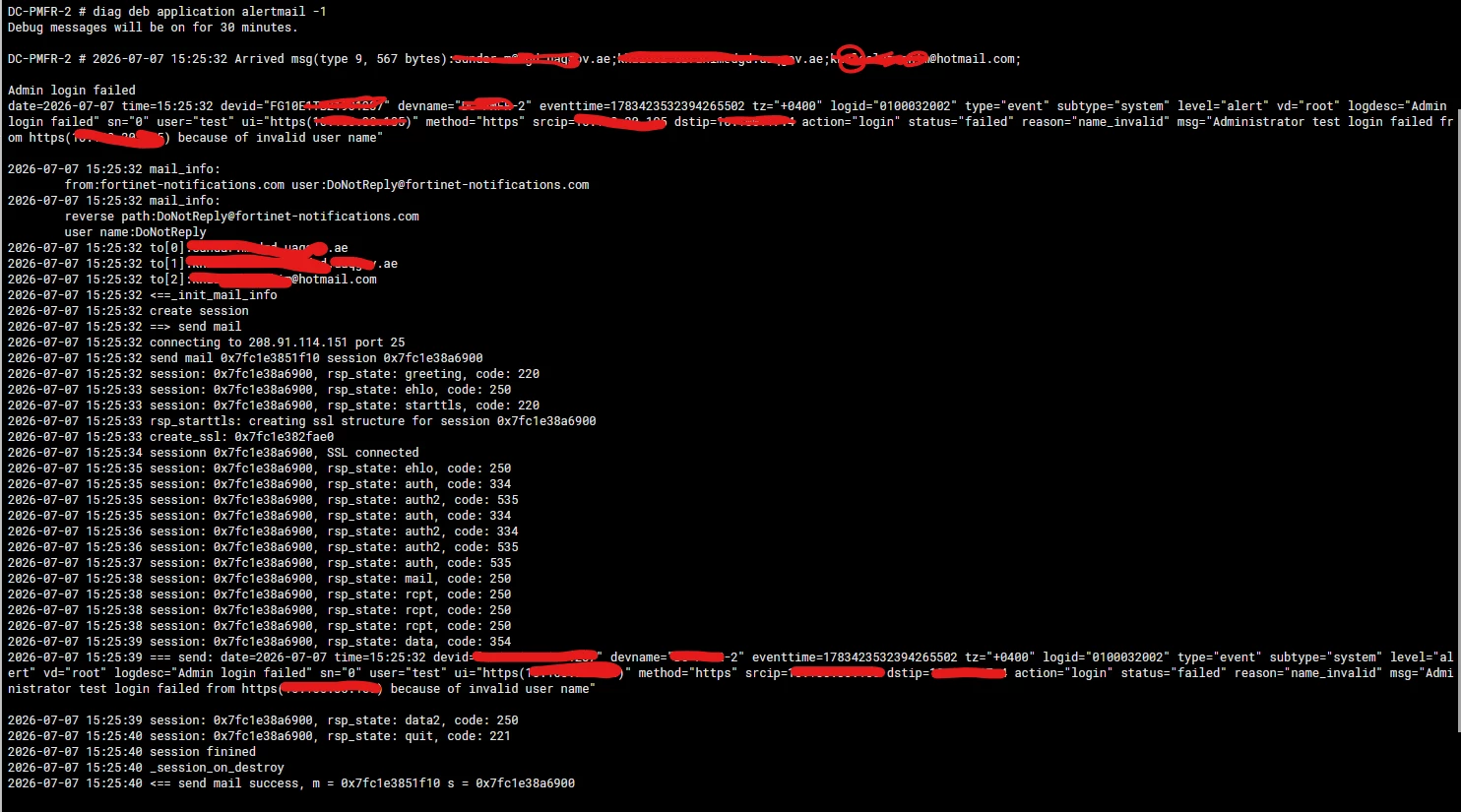

below ss for the automation stitches for admin login failed. Here i recieved the email notification in my company email id but didnt recieved for outlook email.

i can see its sending 208.91.114.151 i believe its fortinet IP address from there its not sending to outlook mail id.

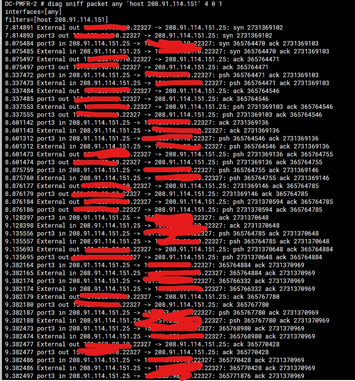

can you do one change
remove the company domain and gmail ID and just keep outlook ID(non working) and share the same debug output.
this time on different console at same time try to collect the pcap
diag sniff packet any ‘host 208.91.114.151 ‘ 4 0 l

Hi ​@Khaleelthe555
from the logs it clearly shows as send mail success. that means from FGT it is able to sent the mail and there is no error.
Also the same config from FGT are working for 2 different domain that itself isolates issue on FGT
I would suggest to check with your email server team if it is blocking anywhere in the mail server and maybe fortinet domain is not trusted in the mail server

Khaleelthe555
Visitor III
July 7, 2026
above is for VPN 2 mfa for outlook mail
