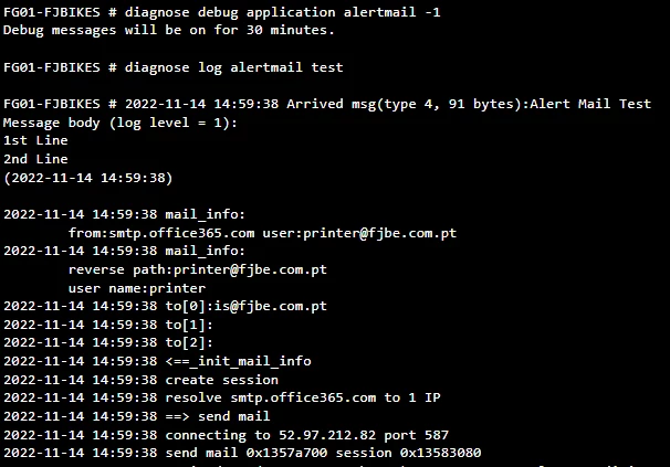

My FortiGate 200D have some problems to send alert emails.
Have many failures in system events.

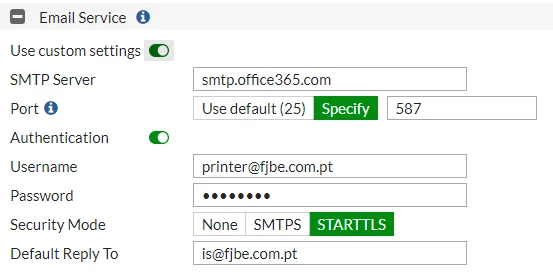

I already check the email service configuration and seems ok. The password is also ok.
The printer@fjbe.com.pt have SMTP enabled and 2FA deactivated.
This is the result of diag

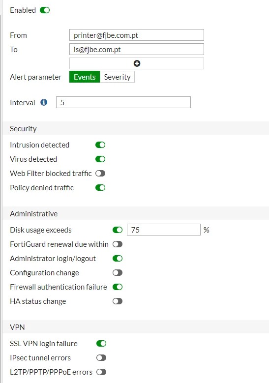

For the printer account have your setup SMTP AUTH in the office365 portal?  This blog article outlines a setup for office365.  The other item they had differently is the default reply to address was the same as the username.  You may need to verify permissions in office365 if that user can send as the is user.
https://aventistech.com/kb/email-alert-with-office-365-in-fortios-6-4/
inferi
inferiAuthor
November 15, 2022
I'm already use that account to send other alerts like backup reports and scanners from our printers

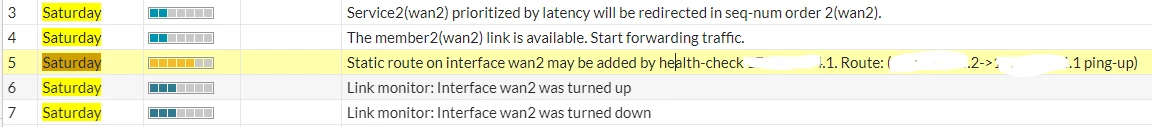

I still not receive alerts from fortigate but saturday I received 3 alert emails.
The timestamp of emails matches exactly with another error with wan2 port.
Maybe the error is from static routes?

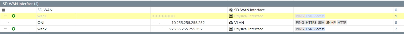

I suspect an issue with SDWAN and the local out traffic picking the right interface.  What interfaces do you have setup for SDWAN? Do they all provide internet access?  Is there only one that is allowed to send emails through O365 by chance?
inferi
inferiAuthor
November 22, 2022
This is the SDWAN
