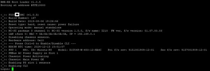

Upon trying to check the status on the CLI, noticed the device is booting on BMR-RX Boot Loader as shown in the bellow image. Now I am kind of stuck to get out of this boot menu and wondering if someone has any idea on how to do it. Some way to set up a TFTP from here or any other option.

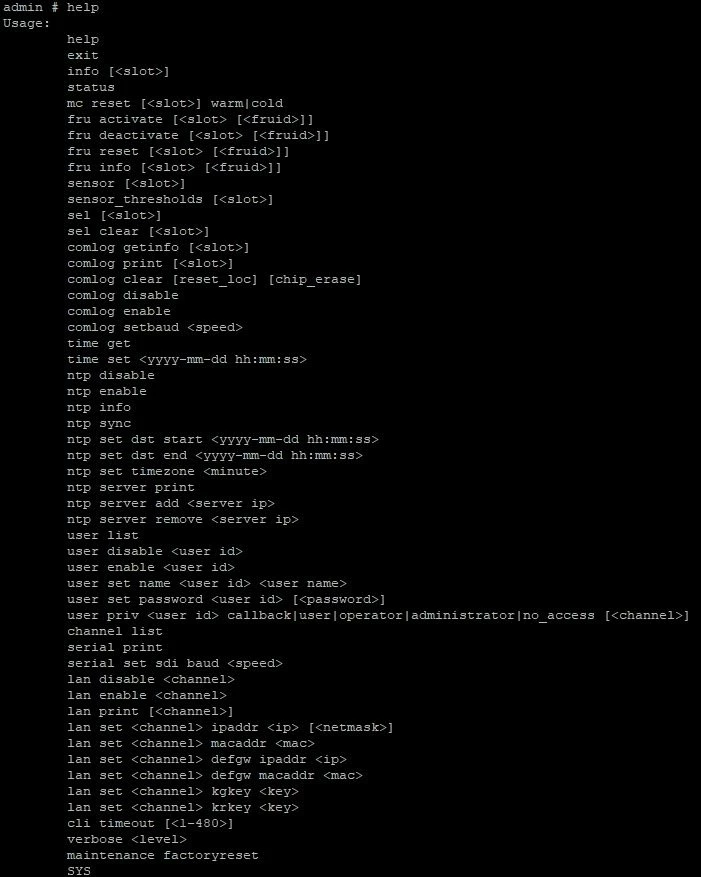

 I was able to login and the menu does not have any useful commands, tried running the "maintenance factoryreset" but always end up on the same place.

Can you tell us what exact model is this?
From the screenshot I can't tell if it's literally a FGT-30 (no letters at the end), or if you obfuscated that part with the white rectangle seen in the picture.

Hello @pminarik!
It is a FGT-300E, I covered the model with the rectangle.

pminarik
December 18, 2024
I don't think you'll be able to handle this without TAC support. This is not the usual BIOS boot menu where you would be able to TFTP upload a FortiOS firmware image, so presumably something goes wrong before that usual boot menu is reached.
