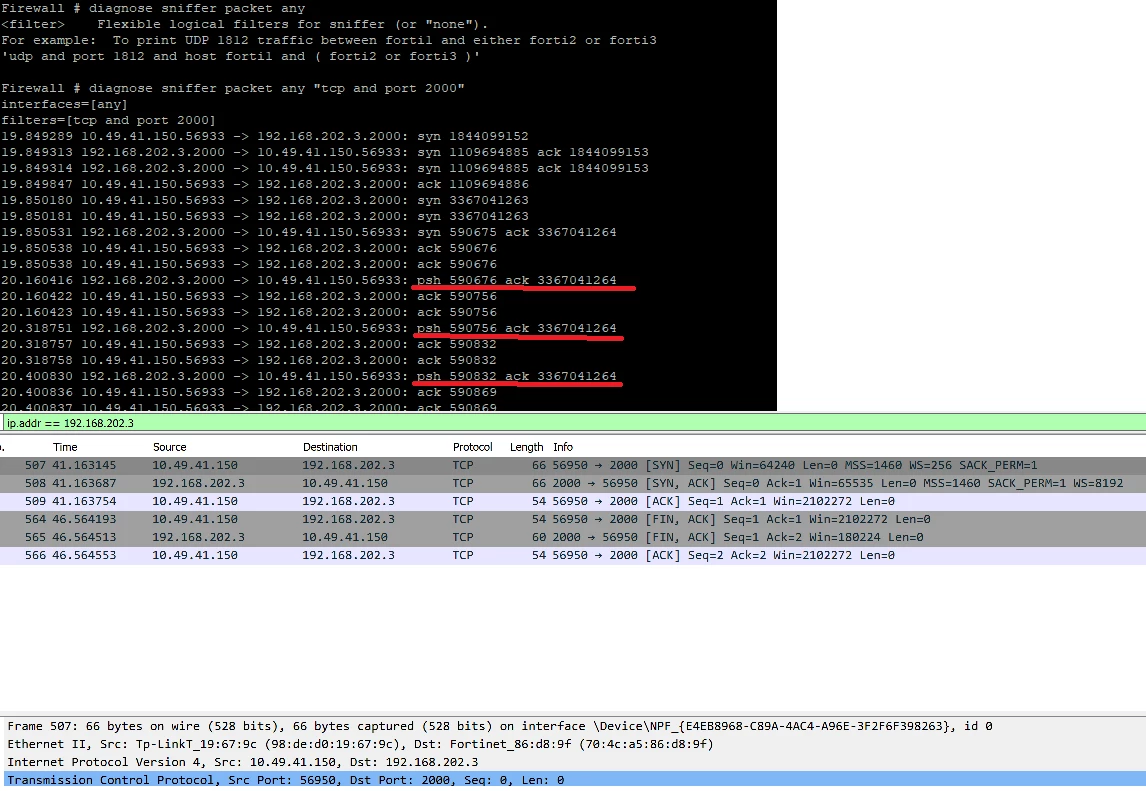

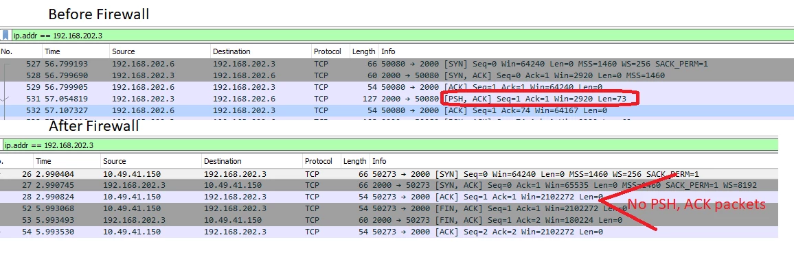

Hello community!
Does someone have any idea what is the issue?
PSH flag in TCP packets is rarely used in common life, but our NMEA-to-IP converter is using this.
Fortigate did not allow it to pass and did not logged it as a blocked.
Session was successfully established - SYN, SYN-ACk and ACK passing through firewall,
but PSH-ACK did not want to pass.
I have played with auto-asic-offload config, np-acceleration and inspection proxy/flow mode it did not help.
Wireshark capture:
Config:

I wouldn't be sure the reason is PSH flag, as it is a valid flag in TCP sessions, and I see it regularly passing FGs without a problem. I'd suggest :
1. Making sure it arrives at the FG and is indeed being dropped by it:
FG# dia sniffer packet any 'Ip of oustide host receiving the connection' 4
And see if the same packet enters and leaves the FG or just enters it.
2. If the above shows packet arrives but doesnt leave the FG, run debug flow to see why:
diag debug reset
diag debug flow filter addr <ip of outside host receiving the connection>
diag debug flow show function-name enable
diag debug flow trace start 100
Then initiate the connection and post the result.

Thank you Yuri for prompt and detailed help!
Sniffer shows the packet is receiving by FG, but it does not go out.
The result of debug below:
[size="1"]id=20085 trace_id=1043 func=print_pkt_detail line=5501 msg="vd-root:0 received a packet(proto=6, 192.168.202.3:2000->10.49.41.150:56976) from GPS. flag [.], seq 611704, ack 1946171203, win 2920"[/size] id=20085 trace_id=1043 func=resolve_ip_tuple_fast line=5581 msg="Find an existing session, id-098026bf, reply direction" id=20085 trace_id=1043 func=npu_handle_session44 line=1139 msg="Trying to offloading session from GPS to vsw.port16, skb.npu_flag=00000000 ses.state=00140386 ses.npu_state=0x00000001" id=20085 trace_id=1043 func=fw_forward_dirty_handler line=449 msg="state=00140386, state2=00000001, npu_state=00000001" id=20085 trace_id=1043 func=av_receive line=305 msg="send to application layer" [size="1"]id=20085 trace_id=1044 func=print_pkt_detail line=5501 msg="vd-root:0 received a packet(proto=6, 10.49.41.150:56976->192.168.202.3:2000) from local. flag [.], seq 1946171203, ack 611741, win 65535"[/size] id=20085 trace_id=1044 func=resolve_ip_tuple_fast line=5581 msg="Find an existing session, id-098026bf, original direction" [size="1"]id=20085 trace_id=1045 func=print_pkt_detail line=5501 msg="vd-root:0 received a packet(proto=6, 192.168.202.3:2000->10.49.41.150:56976) from GPS. flag [.], seq 611741, ack 1946171203, win 2920"[/size] id=20085 trace_id=1045 func=resolve_ip_tuple_fast line=5581 msg="Find an existing session, id-098026bf, reply direction" id=20085 trace_id=1045 func=npu_handle_session44 line=1139 msg="Trying to offloading session from GPS to vsw.port16, skb.npu_flag=00000000 ses.state=00140386 ses.npu_state=0x00000001" id=20085 trace_id=1045 func=fw_forward_dirty_handler line=449 msg="state=00140386, state2=00000001, npu_state=00000001" id=20085 trace_id=1045 func=av_receive line=305 msg="send to application layer"
I have temporary put old Cisco 1841 between these networks and problem disappeared.
Is there any chance to get this packet passing through Fortigate?

February 14, 2020
Strange indeed, in the FG sniffer if you look 3 lines above where 192.168.202.3 returns ACk it also gets blocked (and no PSH flag), seems like FG drops any returning traffic from 192.168.202 except SYN+ACK. On the other hand the traffic is strange as well - first 4 packets establish successfully TCP session, then instead of using this session, the host 10.49 again sends SYN out of the blue ...
if it is some SCADA/IOT irregular traffic FG may have problems statefully understanding it.
Is it in proxy mode (I see it is, have you tried FLow mode instead?)? Do you have some fancy VIP/NAT ? What does profile do (why custom, not "default")
set profile-protocol-options "NMEA" ?
