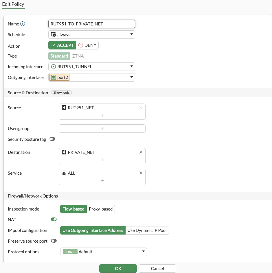

I have both policies allowing all access from RUT951 -> PRIVATE NET and PRIVATE NET -> RUT951 like below:
PRIVATE NET -> RUT951 Policy (This one does not work if doing ping or telnet disabling or enabling NAT, same result).
RUT951 -> PRIVATE NET (This one works perfect i can do ping or telnet)

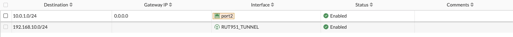

Static Routes

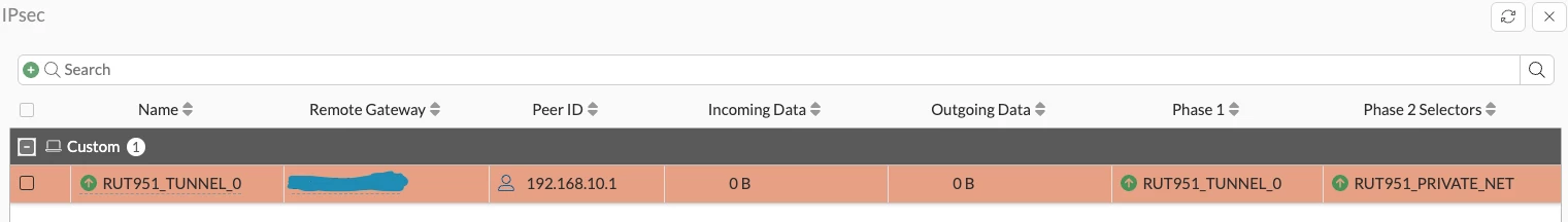

IPSEC TUNNEL SITE TO SITE SUCCESS STATUS.

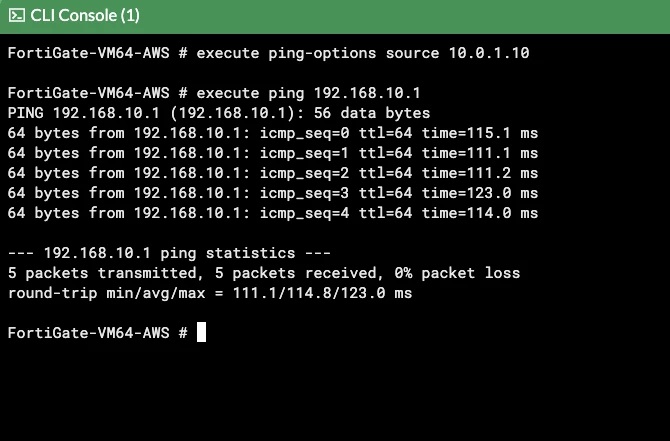

Hi @OrtizJorge97 ,
Please specify the source IP for Ping on FGT:
execute ping-options source x.x.x.x  // x.x.x.x is the IP assigned to port2
execute ping 192.168.10.1

December 11, 2024
Hi @OrtizJorge97 ,
OrtizJorge97
December 11, 2024
Looks like my router is responding and also devices behind itScreenshot 2024-12-10 at 6.40.39 p.m..png
it is weird that from my server in the private net (interface port2 10.0.1.10), it is not responding the ping
