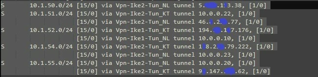

Hey guys. I am an FGT90G owner.
Do you have any problems with Traffic Shaper?
I have installed different firmware 7.0.12, 7.0.13, 7.0.14, 7.0.15.
On all firmware there is a problem with Traffic Shaper.
I have configured a few rules in Traffic Shaping Policies. The network works fine, but after a few hours, all traffic that matches these rules stops working. After that, I disable the rules in Traffic Shaping Policies and my network works again.
If I re-enable the rule in Traffic Shaping Policies, the network does not work.
In the logs I see errors - Session time out.
The problem is solved only after rebooting the FortiGate.
There is a second problem.
It is only present in versions 7.0.13, 7.0.14, 70.15.
I have 29 pieces of Zyxel usg-20-vpn connected to FGT90G as Dial-Up IpSEC.
After rebooting the FGT90G or Zyxel, no access to the internal network of some Zyxel.
After entering the command "get router info routing-table all ", I see:
S 10.1.51.0/24 [15/0] via Vpn-Ike2-Tun_KT tunnel 10.0.0.22, [1/0]
[15/0] via Vpn-Ike2-Tun_NL tunnel 44.7.263.77
But PING to 10.1.51.0/24 doesn't work.
I enter the command: diagnose vpn tunnel flush
After that I can see the network 10.1.51.0
S 10.1.51.0/24 [15/0] via Vpn-Ike2-Tun_KT tunnel 44.7.263.77, [1/0]
This problem is not present on firmware 7.0.12.
Do you have this problem?
