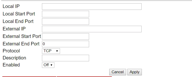

hi everyone (:,
i have at my home firewall fortigate 90d that connected to my isp router  the firewall connected to my local network (192.168.1.15) the isp is the main router to internet  and i want to do port forwarding to the GUI in the firewall from outside
and i dont know how to do it this is my isp router "port forwarding " setting i attached the file

    Hi,
    If you want to manage the Firewall GUI from Outside i think you should configure your ISP Router as follow:
    Local IP : 192.168.1.15 ( I assume it's the Fortigate IP address )
    Local Start Port:443 ( By default Fortigate GUI is accessible on that port if you did change that )
    Local End Port: 443
    External IP: the ip address of your router
    External Start Port:443
    External End Port:443
    Protocol: tcp
    Description. Fortigate GUI
    Enable: on
    Hope it'll work for you.

    June 20, 2019
