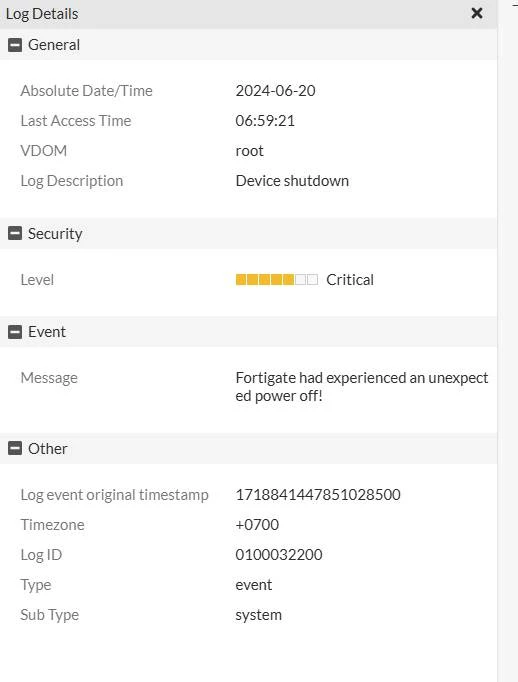

FortiGate-901G v7.4.3 build2573 Fortigate had experienced an unexpected power off!

How should I solve this problem? Fortigate had experienced an unexpected power off!

Did you get a log message?
Have you confirmed if you had a power outage?
kitti1
kitti1Author
June 21, 2024
Did you get a log message?Yes
Yes, 2 PSU Separate power supply
1 psu Connect to power supply  A
2 psu Connect to power supply  B

kitti1
kitti1Author
June 21, 2024
this log System

Hi @kitti1,
Did it happen multiple times or just one time issue?
Regards,
spoojary
June 21, 2024
Do a console and wait for it to reboot and check the logs which come, could be a kernel panic.
