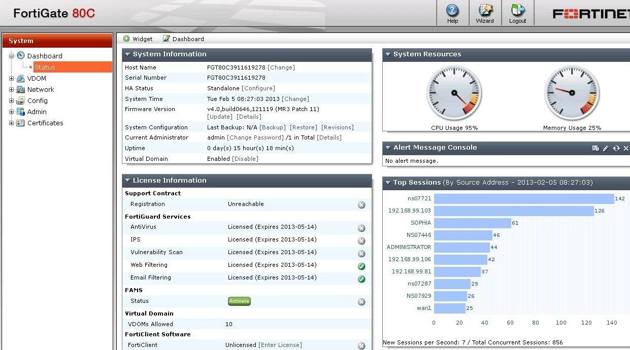

Hi there, I an newbie here. Just got a problem for 80C. It stopped working occasionally, nobody could go to internet. When I login it show on Dashboard that Registration unreachable. AntiVirus, IPS and Vulnerability Scan all failed. CPU usage was around 95% high. When click on CLI Console it shows Connected but with error: Cannot read termcap database, using dumb terminal setting. All log file are missing. When I tried to reboot it just hang. I have to disconnect the power and wait for a few minutes. after trun it on normally it works fine. Checked the log after restarting, it stopped logging anything sometime a few hours ago. It seems this more often since this January. I am not good at Fortigate and CLI. If you have any ideas about this issue I am glad to hear. Thank you. The screenshot is below.

    Hi Jerry. Welcome to the forums. I have noticed you have vdoms enabled -- was that your doing and/or do you actually need vdom support on the Fortigate? That may be your problem right there.

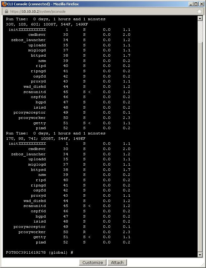

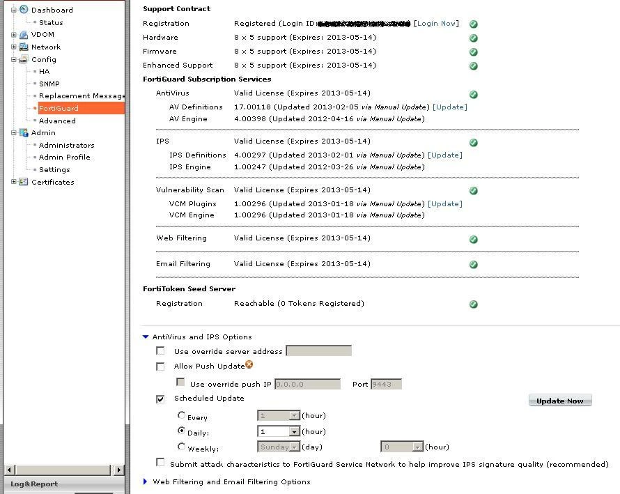

    No. I mean, you' ve got 2 obvious problems: high CPU usage and Fortiguard network not reachable. To check which process eats up your CPU cycles: - open the console - type ' diag sys top 10' - type ' P' - quit after a while, copy the text and post here FG network: - post your settings in System>Config>FortiGuard especially the closed section ' AntiVirus and IPS Options' - tell us how the FGT is connected to the internet (any intermediate routers? NAT?)

    Hello Ede, The result for CLI command ' diag sys top 10' :

    Screenshot for FortiGuard config:
