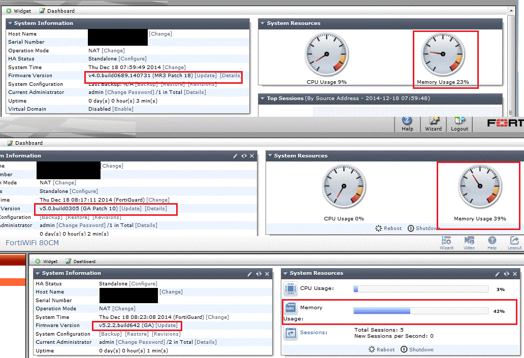

    Last February we conducted our own assessment on the 80CMs (rev1) under 5.0, 5.2 and (even following Fortinet's optimizing guide) were not happy with the memory footprint.   The 80CM with a factory config under the three firmwares, the memory usage looks like this:
    4.3 MR3 patch 18    23% 5.0 patch 10        39% 5.2.2            42%
    With our base (template) config on 5.0.  the memory usage went up to 62-66%.   There was not that much a difference in tweaking the settings, except for changing the cache size for virus scanning compressed files/archives; standard default cache size is 10 MB -- changing this value to say 2 MB would give the 80CM about 8-10 MB more memory.
    Based on the above, we have decided to keep our 80CMs on 4.3. MR3 firmware and look towards replacing them with 92D hardware.
