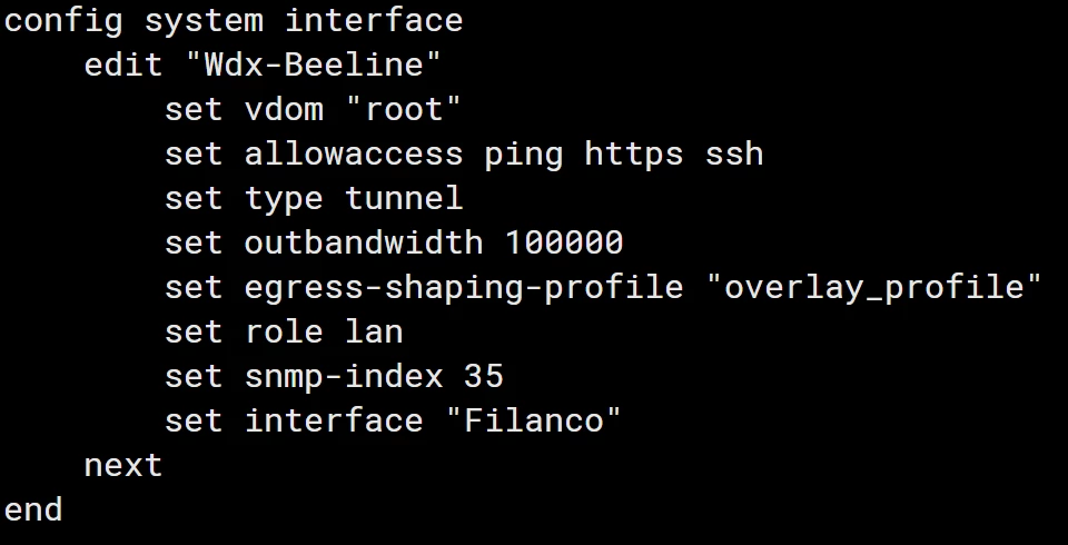

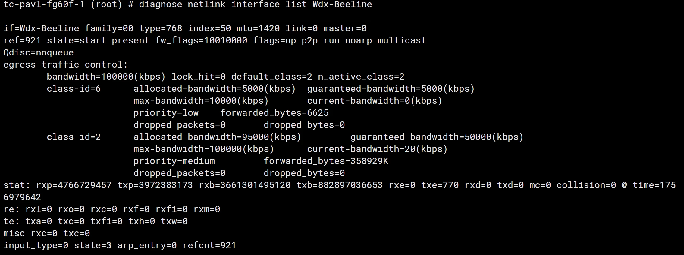

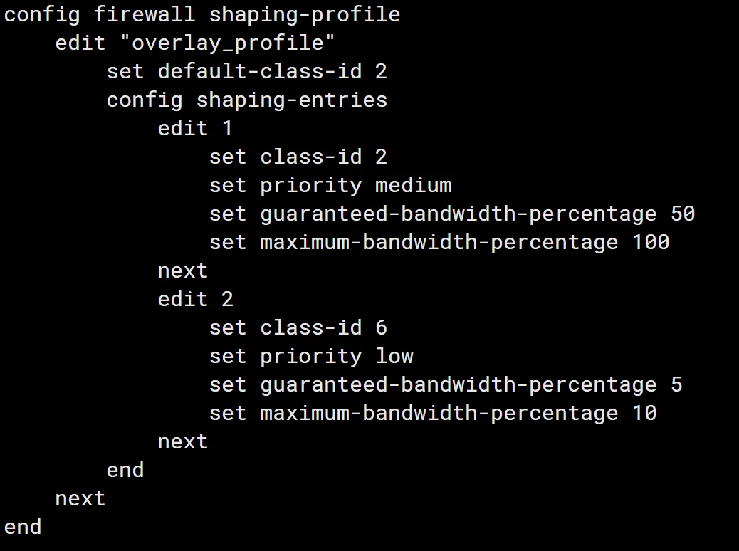

We're facing an issue where traffic shaping on our FortiGate 60F device doesn't seem to be working as expected.Despite setting up the necessary configurations, no traffic appears to be shaped — the system always shows strange current-bandwidth (diagnose netlink interface list) when monitoring shaping statistics. Same configurations works well on Fortigate 100E. At same time shared shaping and per-ip shapers works as expected on Fortigate 60F.
The only thing that makes shaping profiles work on Fortigate 60F is disabling ASIC Offloading in the relevant firewall policy. But we wouldn't want to do that because all the traffic would go through the CPU.
FortiOS version 7.2.9 - 7.2.11
The real upload bandwidth is about 8 Mbps, but the system shows as 27kbps

The FortiGate 100E and 60F models use different NPU drivers. I will investigate your case and try to reproduce it in my lab.

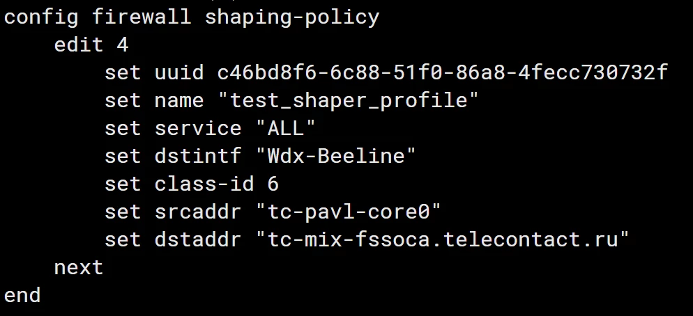

From your pictures, it looks like the shaping policy is also activated along with the shaping profile. For outgoing traffic, the device may process the shaping policy first if the traffic is offloaded to the NPU. Therefore, please remove the shaping policy when performing the test. Many thanks!
