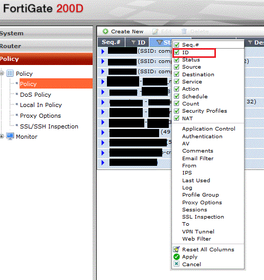

    Firewall polices are auto-assigned IDs when you use the GUI to create them, but usually the ID column is not shown in the default view.  In most firmware versions you can change/define the columns to show by clicking on a column setting option at the top of the policy page.  (In 5.x. you can right-click on column bar).  If you are using 5.x, you can set the default column view, by using...
    config system settings
        set gui-default-policy-columns "#" "col name1" "col name2" "col name3" "col name4" "...."
    Policy IDs are just "labels" assigned to policies -- they do not determine the seq order that they are executed by Fortigate.  (Though you can always use a text editor to "renumber" the IDs to match the seq order.)

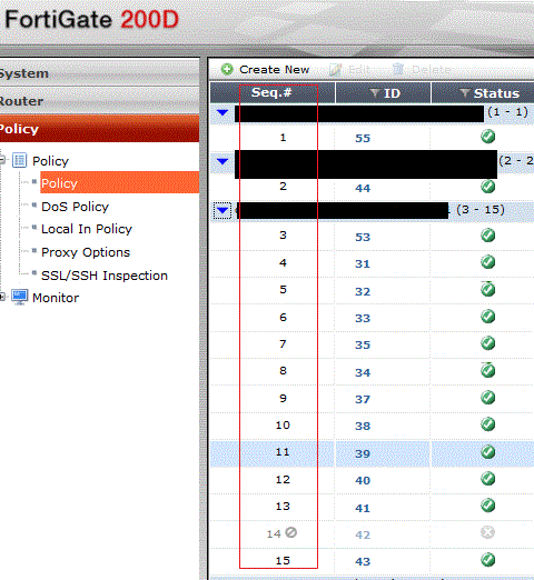

    Thank you for your replies.
    I didn't realize there was both SEQ and ID columns.  The numbers I was referring to were sequence numbers (I didn't have the ID column displayed).
    If the ID is just a label then I presume policies are applied based on the SEQ column?

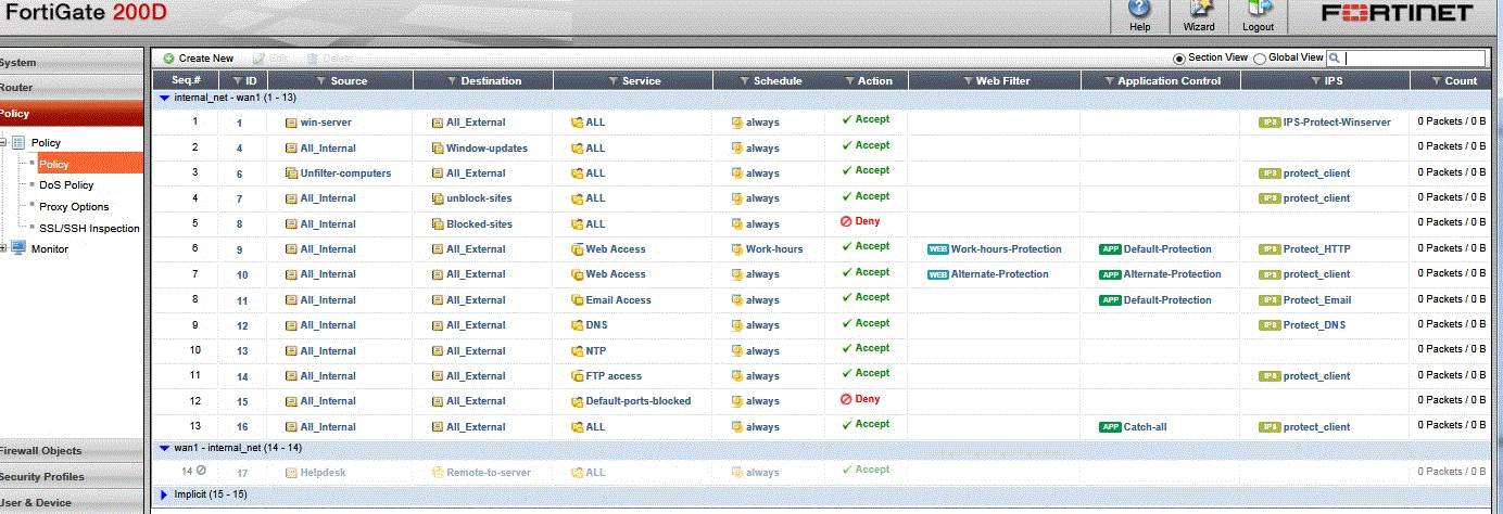

    Dave_Hall
    October 27, 2014
    Policy (firewall) rules are executed from top-to-bottom.  Generally, broader policies are near the bottom of the list with more restrictive or targeted policies at the top... but it depends more on what you are trying to accomplish.  In the sample firewall set (below) is one possible way of setting up the Fortigate.

    I have to agreed. Also, when in doubt login into the  cli and issues a "show firewall policy ". The sequence that's displayed in the CLI is the sequence of the firewall policys. The ID#s are a place holder and have nothing todo with the sequence and inspection.
    All fwpolicies are then inspect by the src int,  then dst int , src address  then dst address, and finally  and the service & action.
