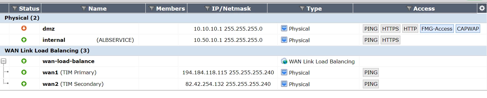

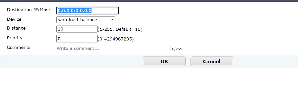

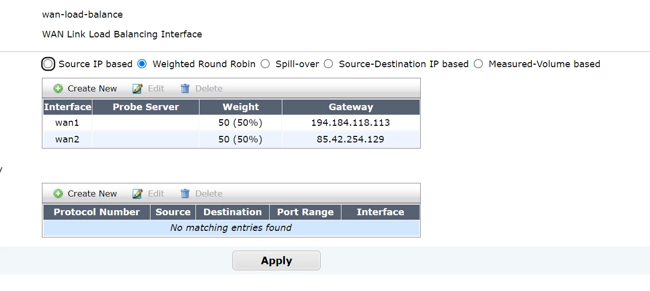

I configured a Fortigate 60D (firmware 5.2.1) with two interface Wan and i created a WAN link load balancing set "Weighted Round Robin 50/50"

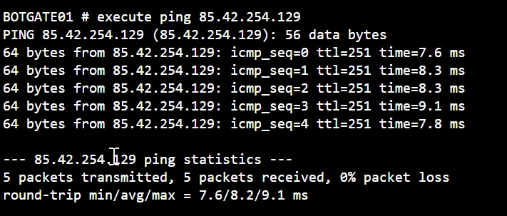

The problem is pretty simple: The Interface wan2 doesn't work in any way.
I disabled interface Wan1, and i'm able with interface WAN 2 to ping the Router via Cli but i'm not able to ping 8.8.8.8
Connected with my laptop directly to the router interface with the same Fortigate's IP address i'm able to surf in internet.
I am not authorized to access the router configuration because they are owned by our ISP.
So 'm not sure where the problem is.
Below some screenshots of my configuration:
12_27_46-FortiGate - BOTGATE01.png12_28_26-FortiGate - BOTGATE01.png12_28_42-FortiGate - BOTGATE01.png12_29_05-FortiGate - BOTGATE01.png12_29_23-FortiGate - BOTGATE01.png12_30_21-FortiGate - BOTGATE01.png

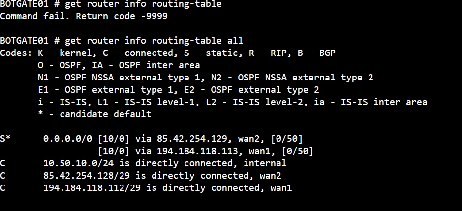

what does your routing look like?
Just because load-balancing is configured doesn't mean FGT will automatically use both links (equally or at all).
I would start with this:
#get router info routing-table all
-> that should provide some info as to what your routing looks like and the default route looks like
-> if you only see wan1, then FGT doesn't have a default route via wan2 and won't use it

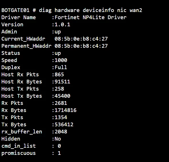

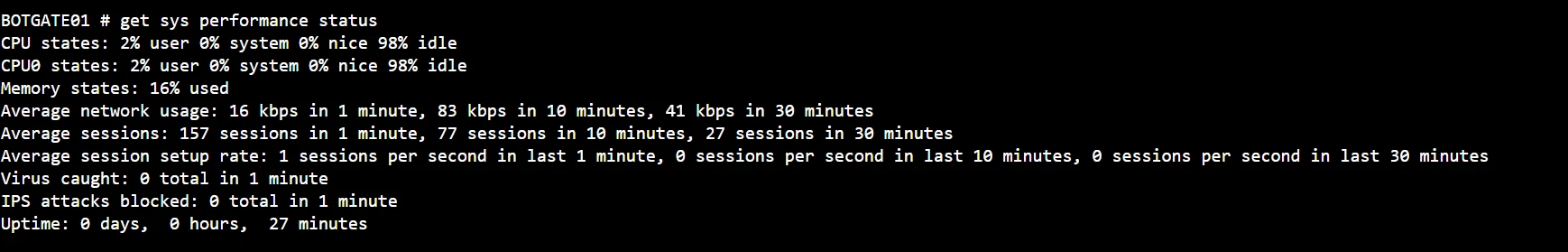

Also, share us the output of these commands:
diag hardware deviceinfo nic wan2
get sys performance status

Thanks everyone for the reply.
So I'm sure the problem is not ISP side because I tried to configure the WAN1 with the parameters of the WAN2 and it worked without problems and I also tried to configure the interface WAN2 with the parameters of the WAN1, and as I assumed the Wan2 doesn't work.
and before you ask me I removed the Load balance and tried to configure the interfaces individually, from the WAN2 I can not surf the Internet with any configuration. In wan1, same configuration everything works.
"Just because load balancing is configured doesn't mean FGT will automatically use both links (equally or at all)."
I understand this point, but if I put the WAN1 interface in "administrative sleep mode", the interface 2 has to start working, otherwise I think there is no point in doing a load balancing.
09_34_57-CLI Console (connected).png09_35_39-CLI Console (connected).png09_36_04-CLI Console (connected).png

May 18, 2022

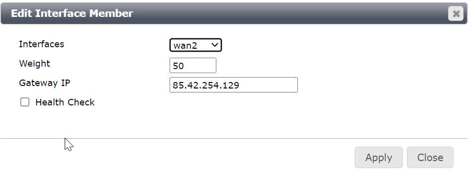

hm did you configure some health check for your loadbalancer? It needs that to detect a non functional internet connection and remove its route.
without the wan goes down but the route stays so 50% packets still go to it...

yes i did! Healt check configurated like this:
Probe type: Ping
Server: 8.8.8.8
Interval 5
Failure 5
recovery 5

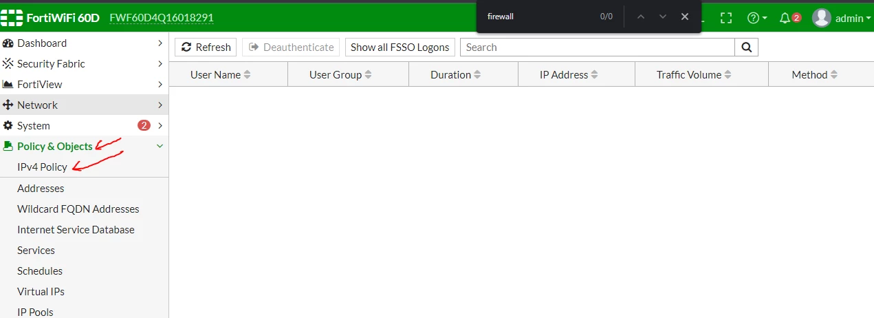

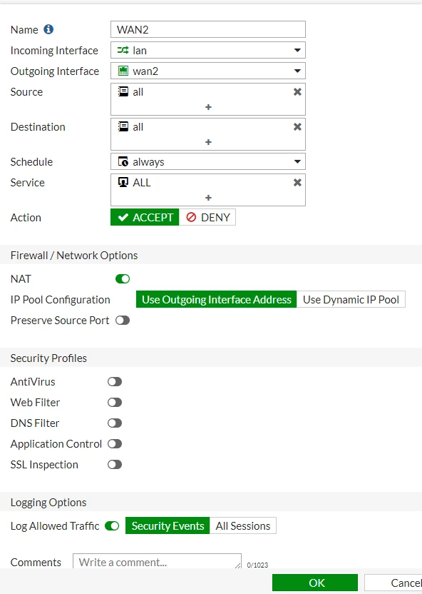

Hello, kind of late, I had the same issue, what I did is: Go to...
under IPv4Policy create a new policy
Copy the values below:
Save and hopefully, that will solve your problem.
