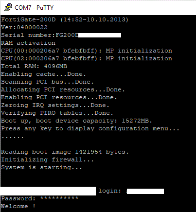

As long as you can see the console output, the fgt should display what is wrong during the boot sequence.
If you make it to the login prompt, sign-in with your admin login then perform the following commands:
diag debug crashlog read get system startup-error-log
If the fgt crashed during or from an upgrade process, using the following commands to see what was messed up during the upgrade process:
diagnose debug config-error-log read
If the fgt doesn't get that far into the boot process to give you a login prompt, but does display the boot menu, you could try breaking into the boot menu (at the press any key prompt) and try booting from "backup firmware".  Though, personally if you are at this stage, I do hope you have at least a backup copy of the config file to be able to restore to in the event you do need to reformat the boot device and restore a firmware image.
If you are not sure what to do, you could always post your console output here for follow up feedback.

You need to keep watching at console output (and save it to open a TAC case) when you upgrade FortiOS. Otherwise you're missing the most crucial information you need when the upgrade fails like your case. I'm almost sure the answer you're looking for was in the output.

Hello Toshi,
Thank you for your reply.
Would you be able to direct me to a post/KB on how to do this? I'm fairly new here and previous firmware upgrades were very smooth and didn't require console yet.
